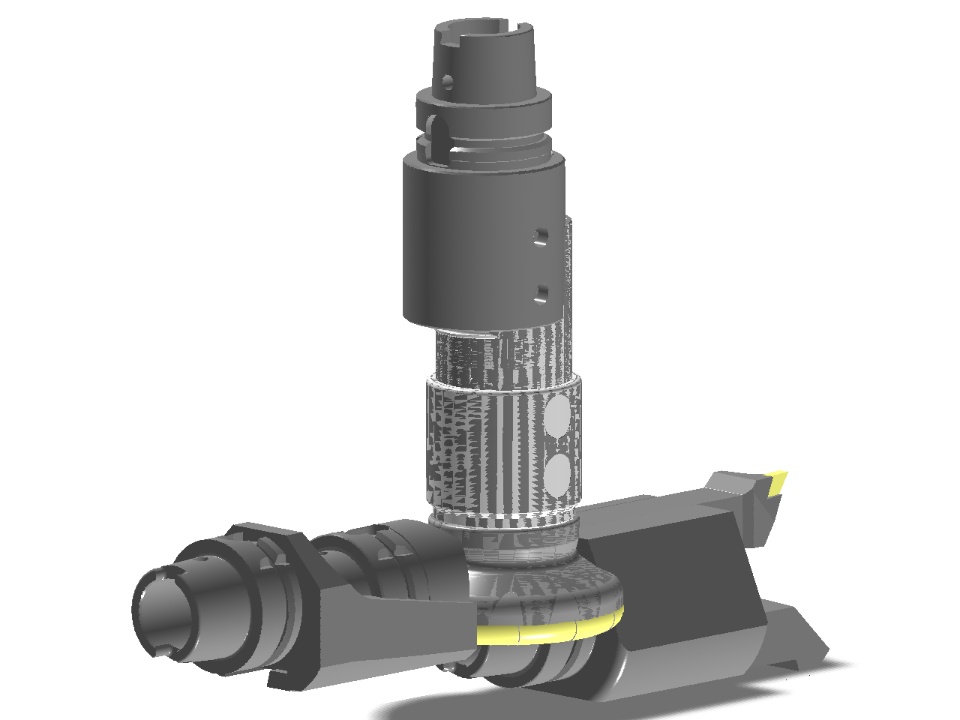

I propose to share with you a PPR with NC assemblies (for demo, test, auto training,…)
PPR Context Assemblies de demo en mm A.1
94 MILLING NC assemblies + 5 TURNING NC assemblies (done mainly with  ISCAR P21 files with  NTT role)

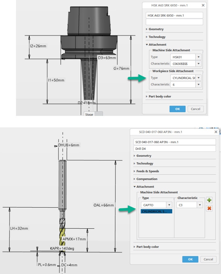

I have changed the attachment definition to the HOLDER_ tool side and TOOL _ Machine side
  •   remove ISCAR code and defined generic name (defined by default in preferences) to be useable  to mount tool for another tool maker or “my” tool
Since R2021x, I used this data for demos or tests
