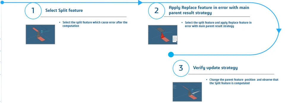

Use Case : Implementation of Replace feature in error with main parent result strategy, on a child feature by replacing the output result of a parent feature.

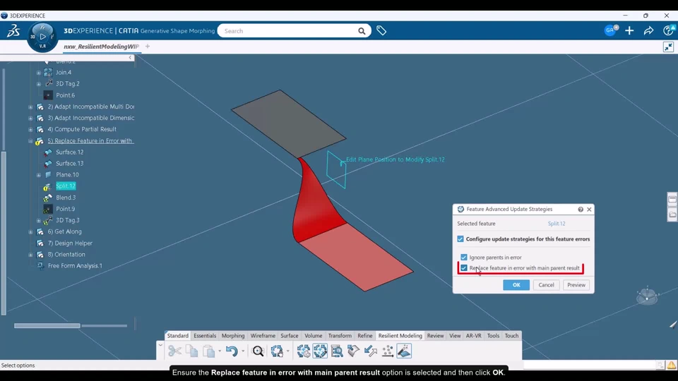

Scenario: In a 3D design, if you have the split operation performed on the surface using a reference plane feature, during updation of reference plane, the child feature split fails. Using the Replace feature in error with main parent result startegy, the child feature error is replaced with parent feature.
Play the video to watch how the Replace feature in error with parent result strategy works for a split feature.
