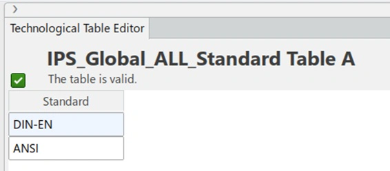

Please find enclosed in this post a complete Piping Resource Set from 2024x  with two Standards :
  • DIN-EN (Default Specification)
  • ANSI

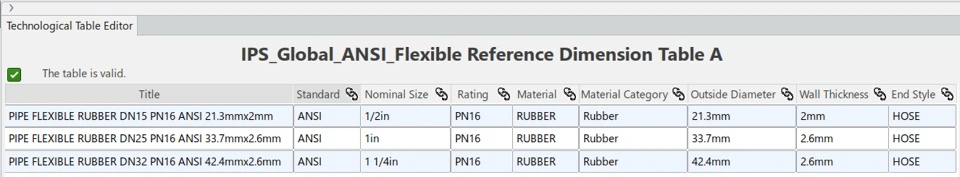

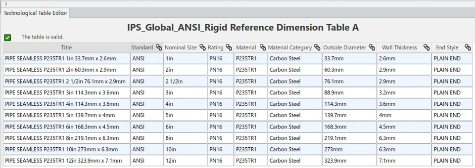

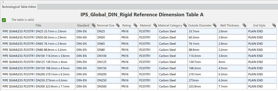

  • 10 Nominal Sizes for Rigid Pipes

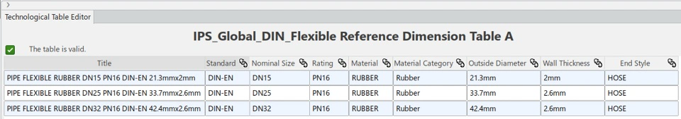

  • 3 Nominal Sizes for Flexible Pipes
  • 3 materials : 1 for Rigid Pipes, 1 for Flexible Pipes, 1 for all the Parts

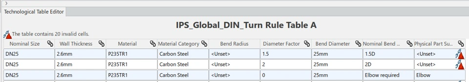

  • Turn Rule Table to automatically place the Elbow

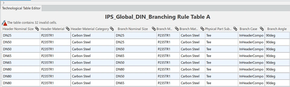

  • Branching Rule Table to automatically manage the Tee junction

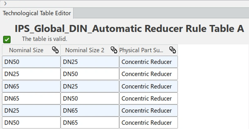

  • Automatic Reducer Rule Table to automatically manage Reducer junction

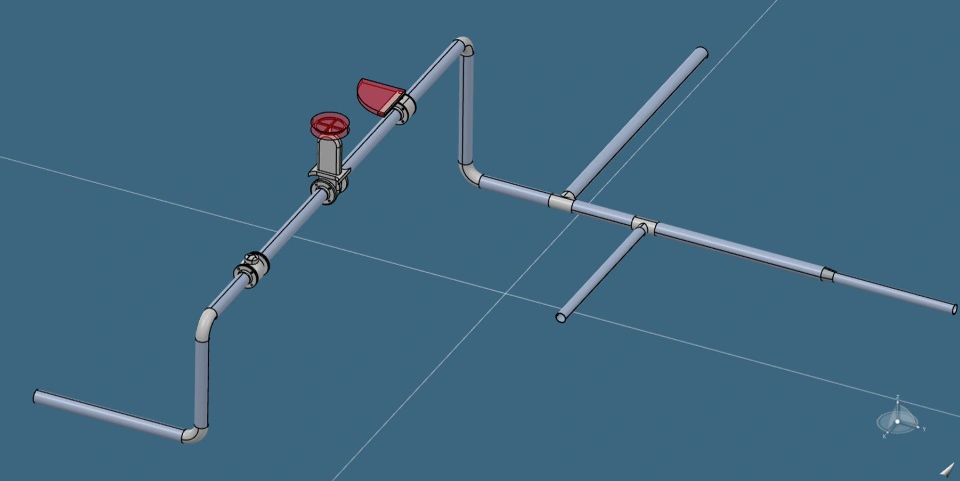

  • Limited number of Parts but enough to engage with any customer - 3 different type of valves:
    • Check Valve
    • Gate Valve
    • Ball Valve

Rigid Pipes
Flexible Pipes
Turn Rule Table (extract)
The one for ANSI Standard is the same

Branching Rule Table (extract)

Automatic Reducer Table (extract)
