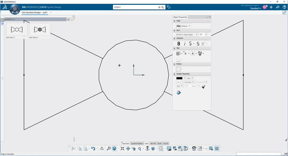

Text template can be defined in 2 different ways (using Symbol editor App or using Drafting App
  • If text template will be placed manually, you can define then either using Symbol editor App or using Drafting App
  • If text will be placed automatically using datasetup Business Rule then they must be defined into symbol editor inside a  "Symbol" in a "logical reference" object

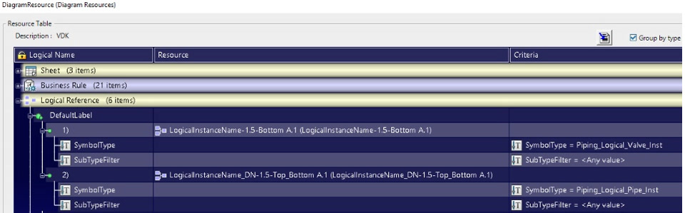

Default Label

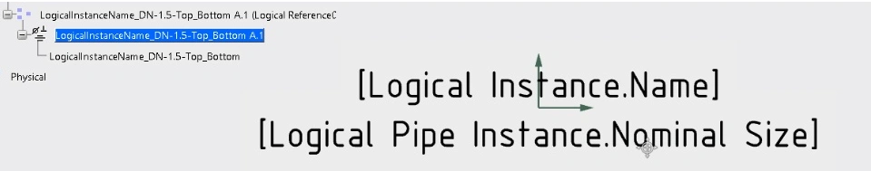

Text template have to be store under a logical reference like :
​​​​​​​The Symbol reference name is taken as output for the BR (last node without icon)
Then this logical reference is pointed on DefaultLabel resource with the SymbolType equal to the logical instance type (for exemple : Piping_Logical_Valve_Inst) :

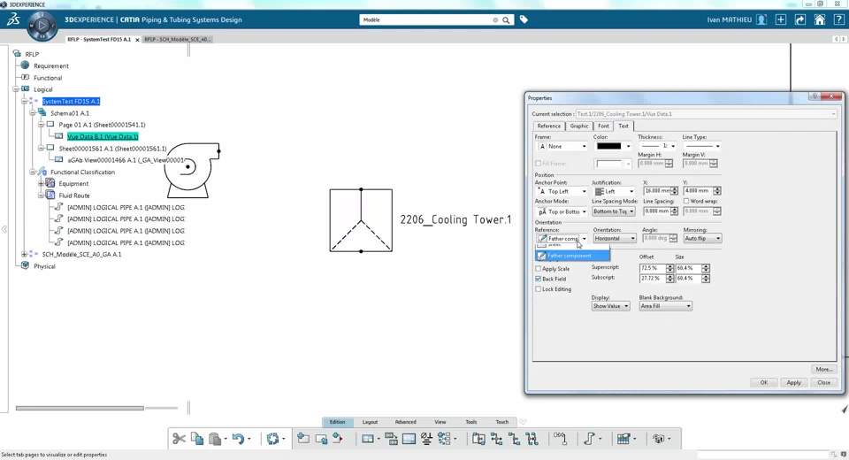

Text & Text template options
Define frame around text:
define shape + line type, color and thickness
Define Frame filling:
define filling color  + marging
Text orientation behavior
following or not the orientation of the symbol on which it is attached
