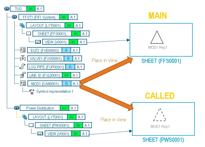

A given component can be represented in multiple sheets inside the same P&ID Layout or in another P&ID.
You must indicate which P&ID sheet is responsible of the definition of this component and which P&ID sheet is just representing the component to connect to but is not the owner the this component.
In 3D experience there is an attribute on the symbol (when compenent is placed in a diagram view) named "Representation Mode" with possible 2 values "Main" or "Called
This will allow to distinguish , if the same component is placed in 2 diferent P&ID Sheet, which one is the "master"
In most of the case the "Main" is the symbol that is represented into a Sheet that belong to the same Parent than the Component itseft ; in other word it meens that the component belong to the same system than the sheet in which it is represented
but it can also happens that the component is represented in 2 differents sheet of the same P&ID and you want to specify which sheet is the owner for the definition of the component

Use case1:
In the bellow rule we are checking if the sheet and the component are sharing the same Object_System (Parent). if yes then the set the symbol attribute to "Main"
