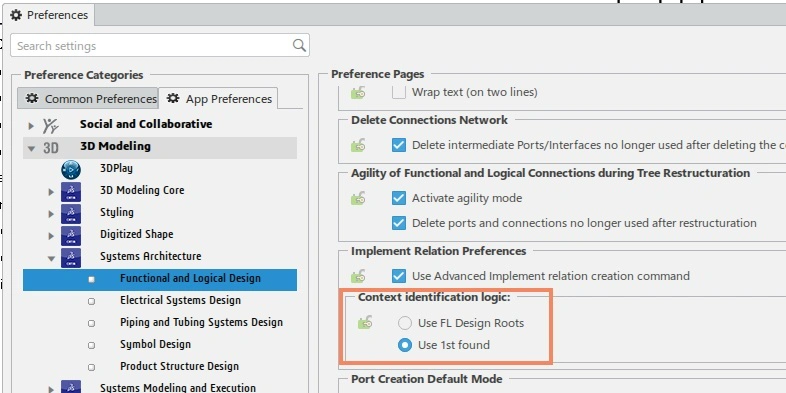

Object and Links management
General
Reduce the scope of implement link to the first common father found

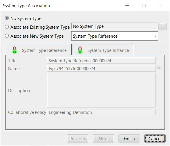

Piping port must NOT have system type associated to it -> Avoid question during port creation to avoid user mistake

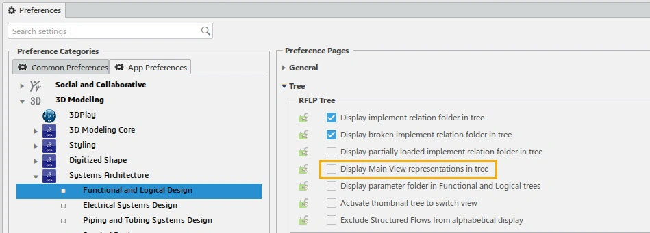

Tree management
General
Hide in the logical tree the Main view. Main view is useless for schematic usage.
Save in PLMEditorColor.xml
        0
Applicative tree grouping
usefull to visualize object per line ID, see object not relying to line ID, list in aphabetical order

  • Avoid port creation on the fly
    • Safer to avoid modifying component by mistake

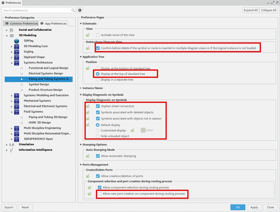

  • View Manipulation : Block the manipulatio nof a View in the Schema (move view position)

Piping and Tubing System Design (Piping and HVAC schematic specific)
  • Delete From Diagram view : before deleting an component,  be aware that the object is represented also in another diagram
  • Applicative Tree : display tree object in an applicative tree grouped per object types (lineID, Equipments, Parts ..). must more easy to navigate in tree to found objects
  • Display diagnostics : Display object in schema with color depending on their status
  • Port management : avoid user error that can create by mistake automaticaly a port on an object just by miss click
