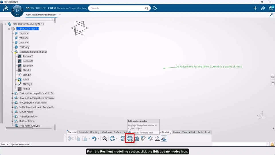

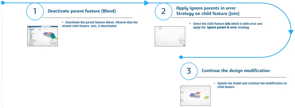

Use Case: To Update a child feature when its parent feature is in error or is deactivated.
Scenario: In a design process, when you want to modify a child feature and if the parent feature is in deactivated or is in error, in a conventional way, it would be challenging to work on a child feature.
Here, with the help of the Ignore Parent In error update strategy, you will be able to work on a child feature even if the parent feature in error mode.
Play the video to watch the implementation of Ignore parents in error strategy.
All the features that you see listed in the What section are beneficial by this strategy. At this point only the GSD and Part Design features are supported.
