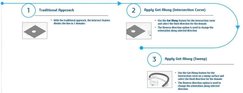

Use Case: Obtain a single domain by using Get Along feature on the surfaceScenario: Let us see a scenario where you have a multi-domain reference for downstream use. By using the Get Along feature, you will obtain a single domai with fix direction refrence. |
