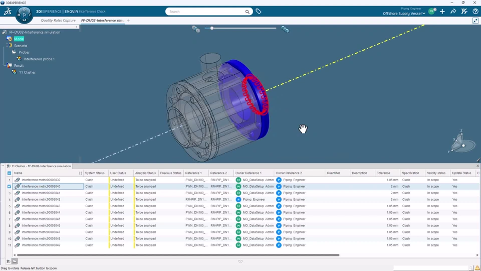

UC1 - Piping
In this example rule allows to remove the clash due to penetration of the pipe inside the Flange :
the numbers of clashes are reduce to only the real one.
Note : This code is very simple and can't be used as such in production.
/* iOcc1 VPMInstance */
/* iRepInst1 VPMRepInstance */
/* iOcc2 VPMInstance */
/* iRepInst2 VPMRepInstance */
let TypeOfCheck(PIM_TypeOfCheckWithRule)
let clearanceValue(LENGTH)
let IsConnected(Boolean)
IsConnected=False
TypeOfCheck = ""
clearanceValue = 0mm
if ((iOcc1.IsASortOf("Piping_Rigid_Pipe_Inst") and iOcc2.IsASortOf("Piping_Flange_Inst")) OR (iOcc2.IsASortOf("Piping_Rigid_Pipe_Inst") and iOcc1.IsASortOf("Piping_Flange_Inst")))
IsConnected = True
if IsConnected
TypeOfCheck = "PIM_NoCheck"
else
TypeOfCheck = "PIM_CheckNoClash"
DefineInterferenceComputation(iOcc1, iRepInst1, iOcc2, iRepInst2, TypeOfCheck, clearanceValue, ThisRule.CreatedFrom)

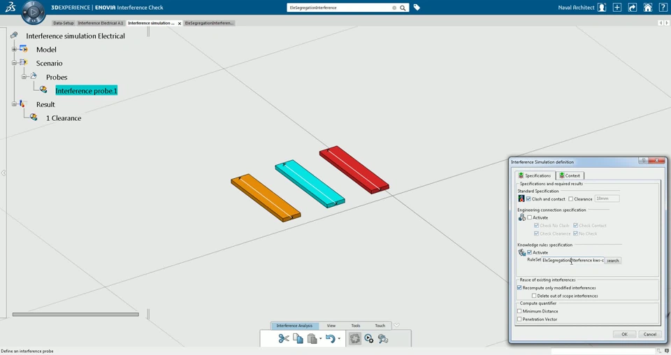

UC2 - Electrical
Thanks to the rules different clearance values can be defined based on segregation :
/* iOcc1 ProductOccurrence */
/* iOcc2 ProductOccurrence */
TypeOfCheck = "PIM_CheckClearance"
clearanceValue = 200mm
if (iOcc1.IsASortOf("ElectricalBranchGeometryOccurrence") and iOcc2.IsASortOf("ElectricalBranchGeometryOccurrence"))
let ustrEBG1SepCode(String)
let ustrEBG2SepCode(String)
let EBG1Segment(Segment)
let EBG2Segment(Segment)
EBG1Segment = iOcc1.Reference.Find("Segment", "", True)
EBG2Segment = iOcc2.Reference.Find("Segment", "", True)
if (EBG1Segment <> NULL)
ustrEBG1SepCode = EBG1Segment.Elec_Segreg
if (EBG2Segment <> NULL)
ustrEBG2SepCode = EBG2Segment.Elec_Segreg
if ((ustrEBG1SepCode == "Signal" and ustrEBG2SepCode == "Power") or (ustrEBG1SepCode == "Power" and ustrEBG2SepCode == "Signal"))
clearanceValue = 50mm
else if ((ustrEBG1SepCode == "Signal" and ustrEBG2SepCode == "LAN") or (ustrEBG1SepCode == "LAN" and ustrEBG2SepCode == "Signal"))
clearanceValue = 100mm
else if ((ustrEBG1SepCode == "Power" and ustrEBG2SepCode == "Safety") or (ustrEBG1SepCode == "Safety" and ustrEBG2SepCode == "Power"))
clearanceValue = 500mm
Notify("Clearance Value : #", clearanceValue)
DefineInterferenceComputation( iOcc1, iRepInst1, iOcc2, iRepInst2, TypeOfCheck, clearanceValue, ThisRule.CreatedFrom)
