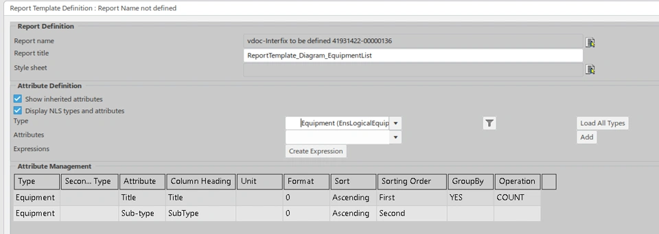

EKL - Report2D - Basic extraction
Report Equipment List
If you want to extract information only from  Logical Equipment Reference into the Report then you can define your report from "Equipment" Type like bellow
