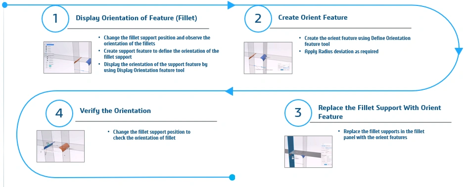

Use Case: Update the Orientation of fillet using Orientation tools
Scenario: Let us see a scenario where you want to control the orientation of the fillet.The Define Feature Orientation tool allow to create orient feature, which further can be used to update the orientation of the fillet surface more efficiently.
Play the video to see the fillet orientations using the Display Feature Orientation tool and later modify them using the Define Feature Orientation tool.
