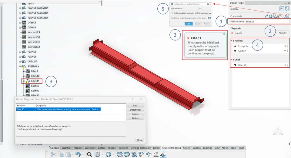

Error Detection - Highlights failed features in the specification tree (marked with a red cross or warning symbol)
- Lists root causes, like missing references, geometric conflicts, or invalid parameters
Interactive Debugging - Offers suggestions for fixing errors like Adapt Fillet Radius,Ignore Parent or Replace Reference
- Allows step-by-step repair of broken features
| Visual Feedback - Shows problematic geometry in the 3D view, like edges where a fillet fails
- Provides previews of potential fixes
Dependency Analysis - Displays parent-child relationships to help identify the features that are causing cascading failures
Resilience Strategies - Integrates with update modes, Automatic, Manual, Smart, and Repair to apply fixes dynamically

Key Features of Design Helper| Function | Description | When to Use |
| Error Explanation | Describes why a feature failed (Edge no longer exists). | When a feature turns red and you need to understand the cause. | | Suggested Fixes | Proposes solutions like Adapt Fillet Radius or Replace Parent. | To quickly resolve common errors. | | Graphical Debugging | Highlights problematic geometry in the 3D view. | For visualizing where a feature like, fillet breaks. | | Dependency Graph | Shows how features are linked, like a pad depending on a sketch. | To trace why a change broke multiple features. | | Repair Mode | Attempts to automatically fix errors during updates. | When manually fixing each feature is time-consuming. | | Ignore Parents in Error | Allows a feature to update even if its parent is broken. | For temporary workarounds during design iterations. | | Replace Reference | Swaps a broken reference like, an edge with a valid one. | When a referenced geometry is deleted or modified. |

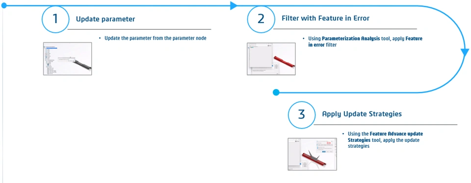

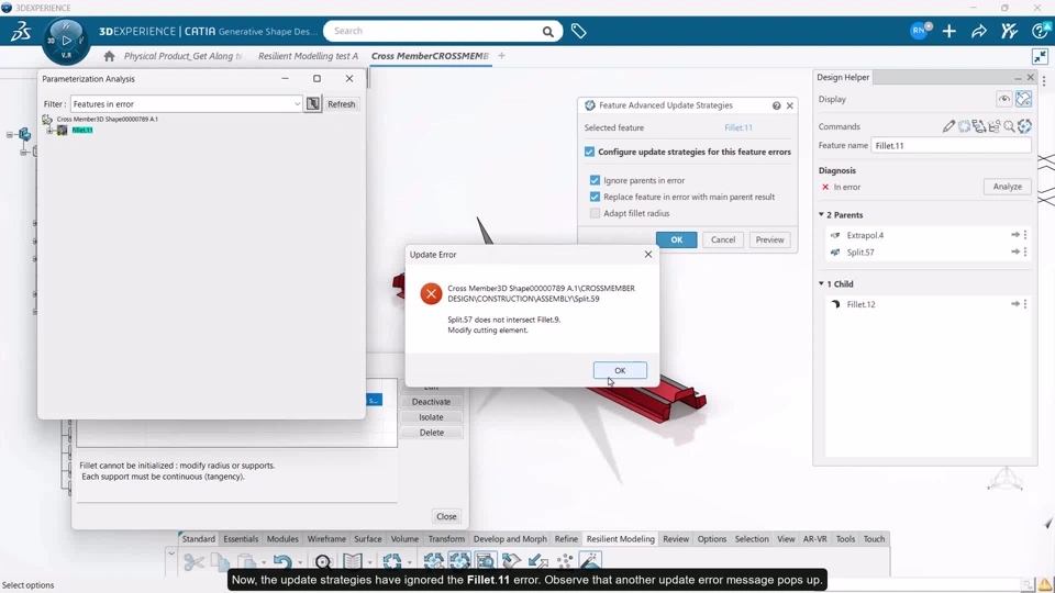

Use Case: Use the Design Helper to identify and fix the feature failuresScenario: Let us see a scenario where a feature has failed and how it is diagnosed using Design Helper.  |
Play the video to explore how Design Helper is used to resolve feature failure. |
Design Helper works seamlessly with tools like Smart Update Mode and Parameterization Analysis.
