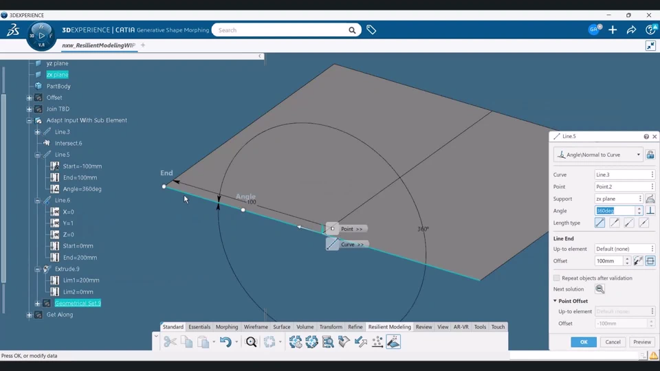

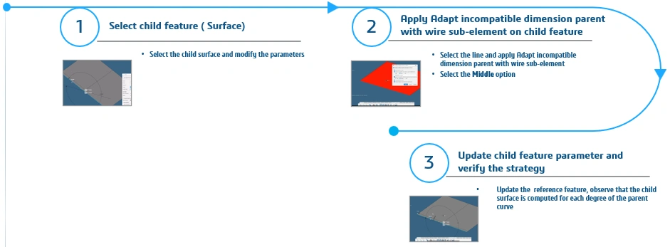

You can choose to extract the Start, Middle, or End point of the wire result. Select this option to compute a point result from an input wire. Line feature provides better result with this strategy.
Use Case : Execute the Adapt incompatible dimension parent with wire sub-element strategy when a parent feature cause error in a child feature.
Scenario: Let us consider a case where a surface is created from a line, and the line is defined using a Point onCurve feature. Now, the curve on which the point is created is positioned at an angle to a reference line. When you change this angle, for certain values of the angle, the geometry becomes invalid, causing the surface to fail.
