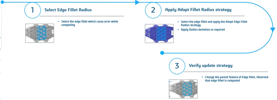

This technical practice focuses on the Adapt Fillet Radius strategy within resilient modelling. This strategy addresses update errors in Edge Fillet and Face Fillet features that result from incompatible radius values. When applied to a fillet feature in error, the strategy allows the designer to define positive and negative deviation limits through the Radius Deviation parameters. Based on these limits, the system recalculates and rebuilds the affected fillet feature using an adjusted radius value, thereby restoring feature validity and ensuring model continuity. |

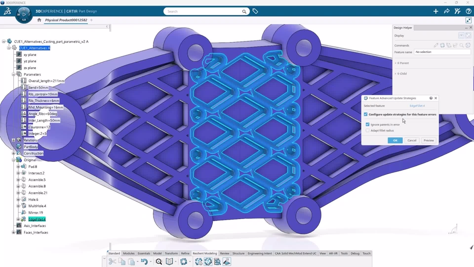

Radius Adaptation Sequence: The strategy evaluates alternative radius values in the following sequence: 1st build: Current radius − 1% of negative deviation 2nd build: Current radius − 10% of negative deviation 3rd build: Current radius − 100% of negative deviation 4th build: Current radius + 1% of positive deviation 5th build: Current radius + 10% of positive deviation 6th build: Current radius + 100% of positive deviation This ordered evaluation ensures minimal deviation from the original design intent while maximizing the likelihood of successful feature regeneration. |
Use Case: Update edge fillet radius in defined deviationScenario: In a 3D design, when you need to update the rib thicknesswhich has edge fillets as child features.You can implement the Adopt Edge Fillet Radius strategy to retain the child feature outputs. This ensures robust updates even when the parent geometry changes. |
