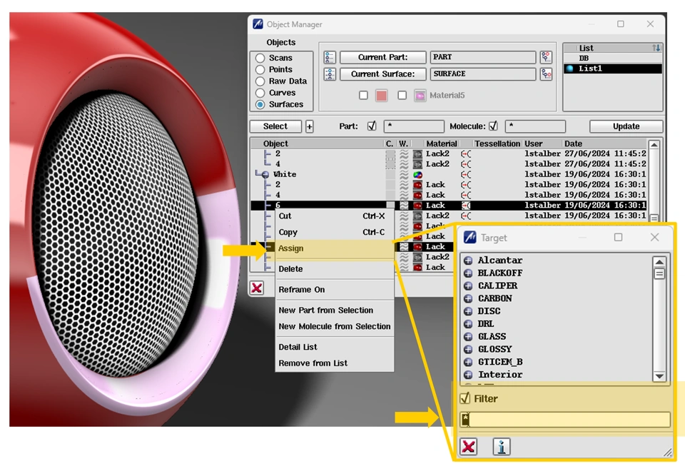

                                                                                                                                                                                                                                    - In Object Manager, additionally to the drag and drop, it is now possible to assign selected objects to an existing Part/Molecule from a current selection through a contextual menu for easier Surface management.
 - After selecting objects in the Object Manager table or in the 3D, use the RMB contextual menu and choose New Part from selection to proceed.
  - NB
- a volatile window will open to select the targetted Part/Molecule.
 - Filter searches in parts and molecules (looks only for molecules)
