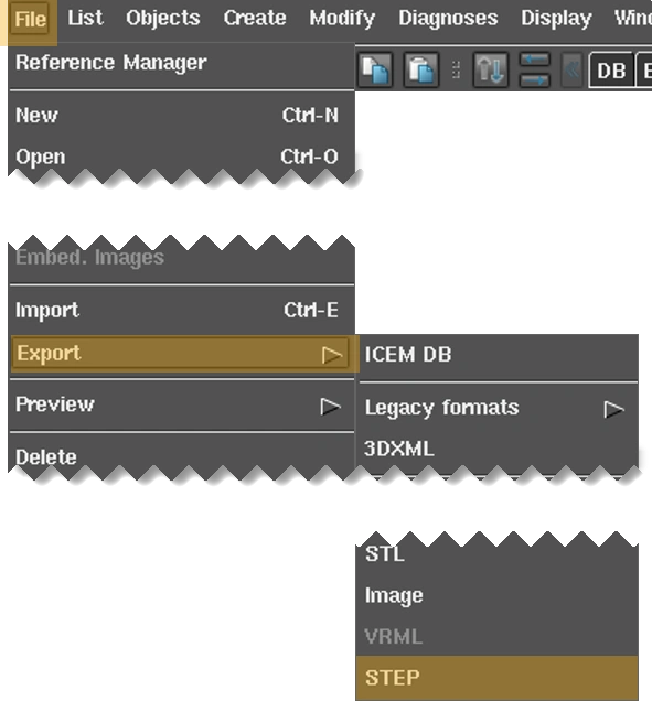

- In ICEM Surf 2025.0, the Import/Export of STP / STEP format is available.
 - This capability is available with the license K28 to be purchased.
ACCESS
- Based on CATIA V5-6_R2025 and 3DEXPERIENCE R2025x
 - Also supported by Reference Manager
 - Batch mode with icutility supported
 - Take care of new directive files
LIST OF PROTOCOLS
A STEP Application Protocol for the desired application area can be selected here.
