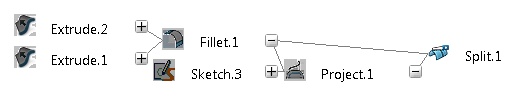

If you display the element's graph using Show Historical Graph in the Review section, you can better relate the elements to its parents:
- The Split.1 is the last generated element, to the left of the graph, and is displayed in green.
 - The Project.1 is its direct parent, as shown in the graph and is displayed in red.
 - The Fillet.1 is another direct parent, but is also the generating one, as it is the first element that unites other independent elements (the extruded surfaces ) that lead to the creation of the Split. Therefore it is displayed in purple, the precedence being given to the generating element over the direct parent.
