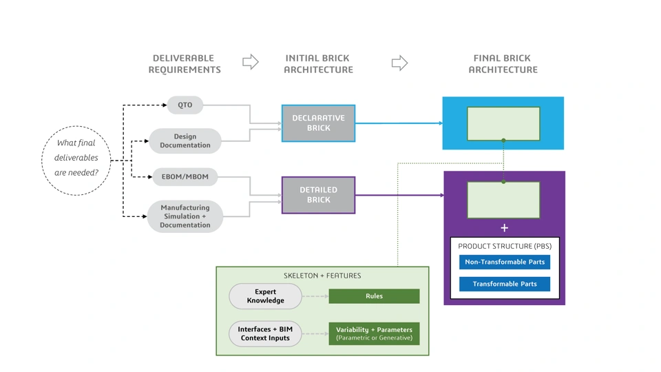

To establish the requirements for both the Declarative and Detailed VCBs, it is important to start with by looking at the deliverables by phase. Typically, Quantity Takeoffs (QTO) and Design Documentation uses "schematic" information--the approximate number of elements can be determined or represented for costing without the model having the full detail fabrication information. This provides a lightweight representation of the model where modifications might still be required as described in the VCB Implementation Process.
Technical Definition Process Summary
  1. Decide on Deliverable Requirements (based on business needs).
  2. Define VCB Type (Declarative and/or Detailed).
  3. Setup needed Interfaces and determine typical BIM Context Inputs.
  4. Collect and translate Expert Knowledge to numbers and formulas for use in Brick.
  5. Compose Skeleton Framework and assess whether Parametric and/or Generative automation are required. (Rule: If some elements of the skeleton are added or removed then it is Generative.)
  6. Determine appropriate Variability and Parameters.
  7. Encode Rules for Engineering, Manufacturing and/or Installation from Expert Knowledge.
  8. Plan the Product Breakdown Structure (if a Detailed VCB is needed) including which are Transformable or Non-Transformable Parts.

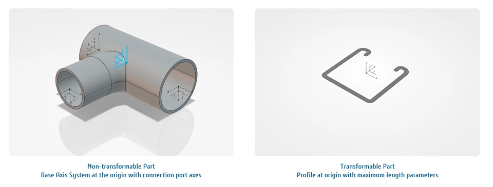

  • Import from your supplier the 3D Data in a Physical Product
  • Add a Base Axis System at the Origin of Physical Product
  • Include relevant connections or parametric data that will define downstream functionality (such as the ports in the pipe tee example)
Transformable Parts
  • Create a New Part
  • Design the Part using Wireframe and/or Volume features.
  • Define its specification parameters (PartNumber, dimensions, id, ...)
  • Create a UDF of the design including the specification parameters. (This UDF will be referenced in the Visual Script for generative/physical transformation.)

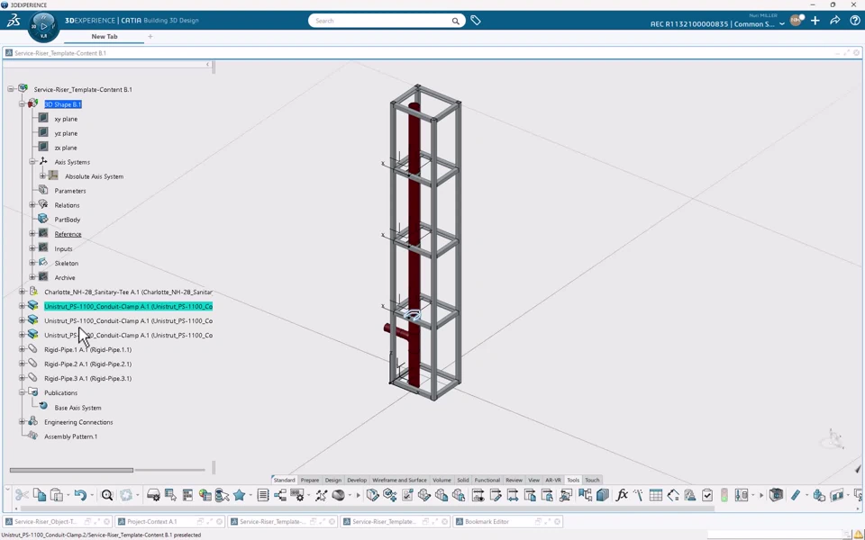

  • Create the Brick Product (Use an AEC Type corresponding to your Brick)
    • Insert a 3DShape
      • Create a Resource Table and link the Transformable Part UDFs
      • Create an Axis System at the Part origin. It will be used as the Base Axis System (This Axis will correspond to your Brick Origin)
      • Create Geometrical Sets for the Brick Inputs and the Interfaces. (It is recommended to also create a Geometrical Set for the construction geometry.)
      • Design the Brick Inputs around the Brick Origin
      • Define the Brick Parameters
    • Publish the Base Axis System (required to use in a Component Spec for instantiating the Brick)

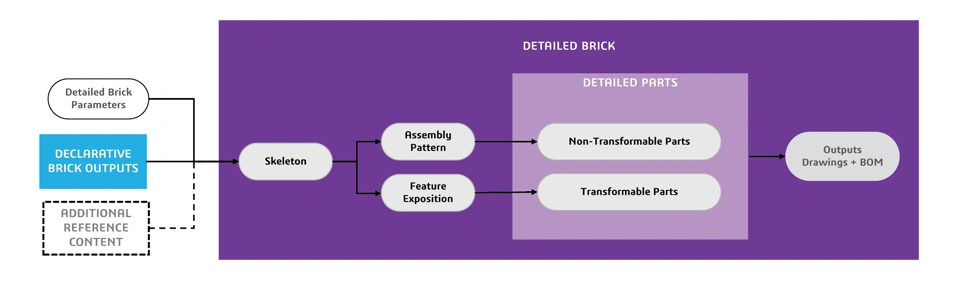

Detailed (Close-up)
Organisation
  • Skeleton
    • Parameters
    • Outputs
  • Drawing + BOM
  • Non-Transformable Parts
  • Transformable Parts
  • Assembly Pattern
Relationships

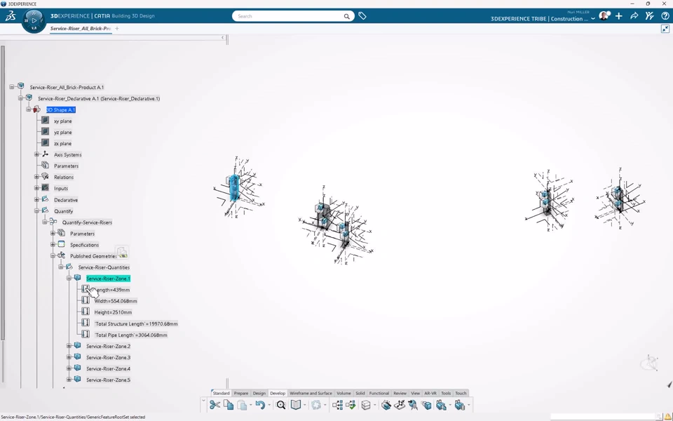

Complete VCB Instantiation Example of a Service Riser
Service Riser Demo
This demo explores the use of a virtual construction brick in a new project. The video covers:
  • Typical Elements & Organisation of a VCB
  • Engineering Template (VCB) Instantiation
  • Transfer of geometrical inputs from a project into the Declarative VCB
  • Adjusting specifications of Declarative VCB before Detailed VCB
  • Expose detailed components through change of LOD
  • Providing downstream information for collaboration
