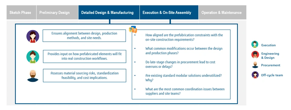

Productization and Continuous Level of Development (LOD)
Virtual Construction Bricks are implemented in stages to allow users to modify specifications in context. Generative assemblies are built on top of previous stage content as separate Parts meaning both LODs are accessible. Connectivity existing across all scales and LOD meanings that at any point in a project life-cycle a design change can automatically drive change at every scale (e.g. from overall building massing down to the attachment hardware for a façade panel).
- "Preliminary Design" phase: The user of a VCB needs a light weight version of the element in order to give a perspective of the project data specific for construction in order to create simplified deliverables (quantities, location plan) or to provide early feedback about construction feasibility.
- "Detailed Design & Manufacturing" and "Execution & On-Site Assembly" : Capitalisation of the knowledge and know-how of fabrication, construction and operation experience (typically self-performed activities where the contractor is in control of the process involving materials, assets and people)

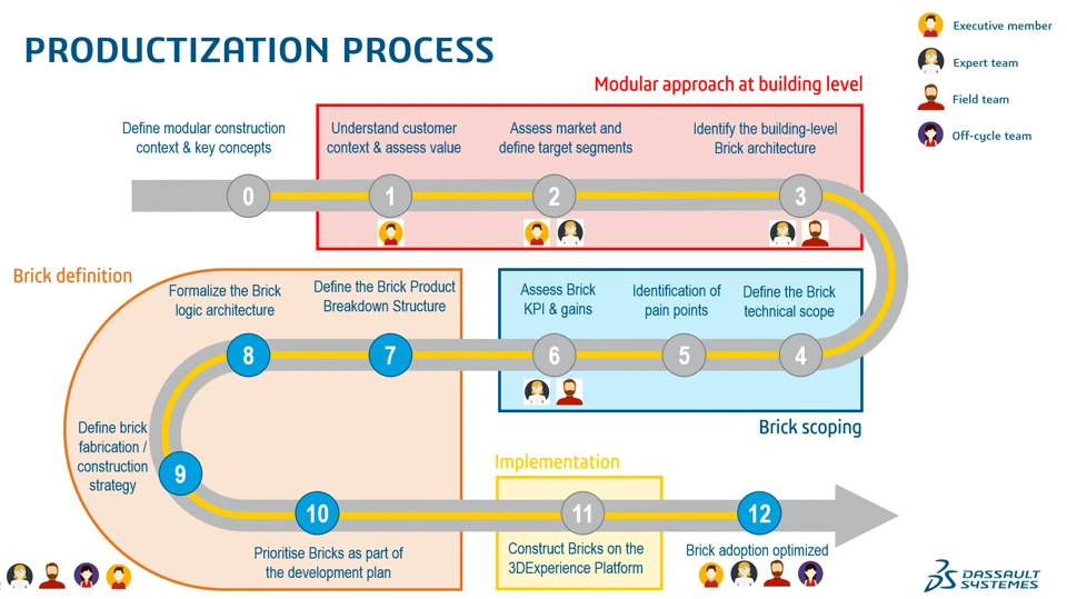

Brick Definition Process
In this best practice, we focus on the technical implementation (step 11) whose DEFINE is done during the brick engineering step (7,8,9,10)
The result of these steps will be the company business value model, a building product breakdown structure with a list of strategic Virtual Construction Bricks, and the business KPI/benefits for those VCBs along with the requirements, deliverables, embedded knowledge, rules and product breakdown structure in a technical package ready for coding referred to as Brick Technical Sheets.

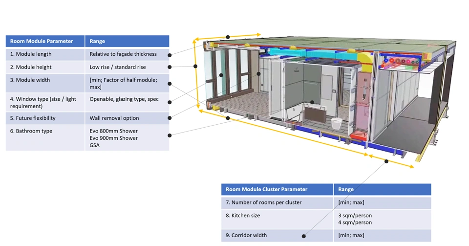

Interfaces, Behaviours and Logical Architecture
It is critical to define standard interfaces and dimensions to enable modularity. When VCBs are assembled into a Virtual Construction Twin, it is managed behaviour of the input parameters that will determine a successful implementation. Consider the way in which each of the following parameters affects the module below:
Each parameter reflects different activities. For example:
- The bathroom type reflects explicitly define components that will impact the space available and connections to vertical services
- Module with changes by preset increments up to a limit for transportation
- Window types will be defined by subcontractor interfaces and specifications.

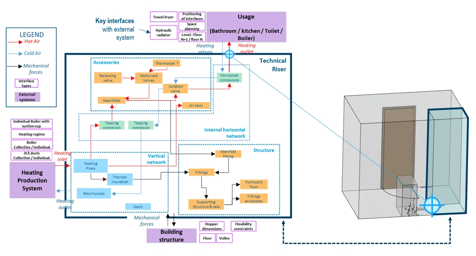

These behaviours are defined in the Brick Definition Process Step 8 : Formalise the Brick Logical Architecture. The logical architecture identifies key interfaces that will ultimately be integrated in the 3DEXPERIENCE Platform and have to be manged between disciplines.

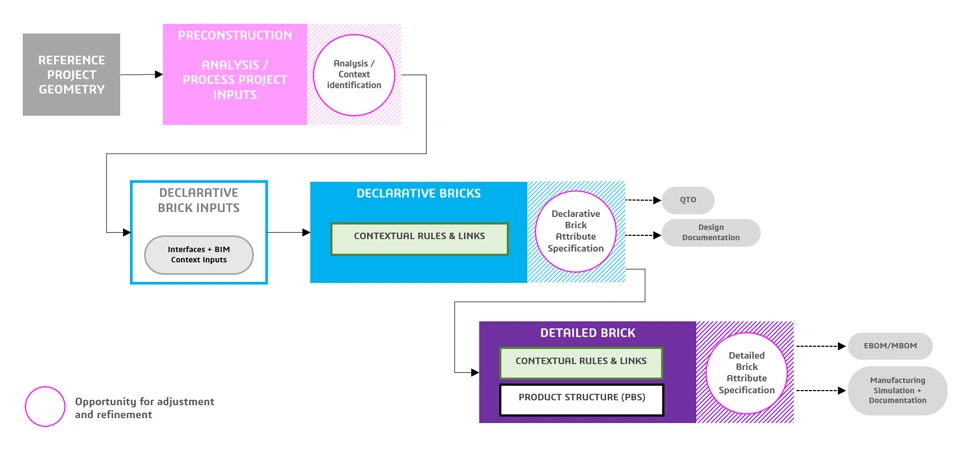

Virtual Construction Brick Implementation Process
While this varies considerably across Project and Customers, the process of VCB implementation should consider the ability for a tailored approach across the development of the project to construction. Where the construction method is clearly defined, it may not be necessary to anticipate customisation at all however the power of the 3DEXPERIENCE Platform provides the ability to do just that.
At the initialisation phase, a reference project comes in, gets evaluated for compliance and is processed to establish the details for construction. The Declarative VCBs refine this information while providing the project with 'intermediary deliverables' like cost and schematic drawings. Detailed VCBs instantiate the manufacturing information for production but can still provide opportunities for fine tuning as required.
