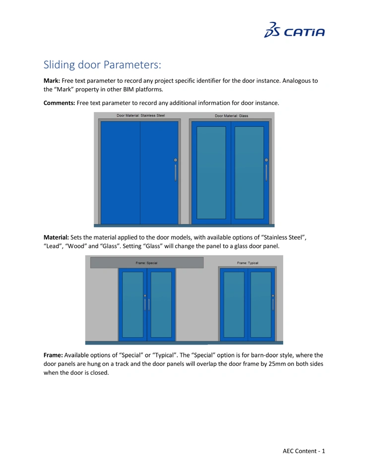

Sliding door Parameters:
Mark: Free text parameter to record any project specific identifier for the door instance. Analogous to the “Mark” property in other BIM platforms.
Comments: Free text parameter to record any additional information for door instance.
Material: Sets the material applied to the door models, with available options of “Stainless Steel”, “Lead”, “Wood” and “Glass”. Setting “Glass” will change the panel to a glass door panel.

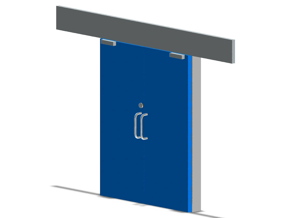

Frame: Available options of “Special” or “Typical”. The “Special” option is for barn-door style, where the door panels are hung on a track and the door panels will overlap the door frame by 25mm on both sides when the door is closed.
Number of panels: Determines the number of door panels with available choices of 1 or 2. The 1 panel option is only available when Frame is set to “Special”.
