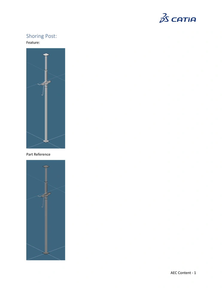

3DXML:
Object Type Name: OT-Construction Equipment-Shoring Post
Documentation:
Input Axis System:
The input Axis System for the shoring post is at the bottom of the post, centered on the bottom plate. X axis is pointing to locking pins.
Parameters:
There are only 1 available parameter:
Height: Parameter defined the total height of the shoring post.
The parameter allows all numerical values between 1000mm to 15000mm inclusive.
During instantiation if enters a value outside of the above range, a notice message will appear.
If enters a value outside of the above range after instantiation during edit, an error message will appear.
Model Behavior to Parameter Changes:
When a value of height is entered, the model will look for an appropriate bottom section length, and when the total height exceeds 2 times the length of the bottom section, the model will automatically switch to a longer bottom section.
The bottom section update starts at 2 meters(2000mm) and happens in an interval of 2000mm.
