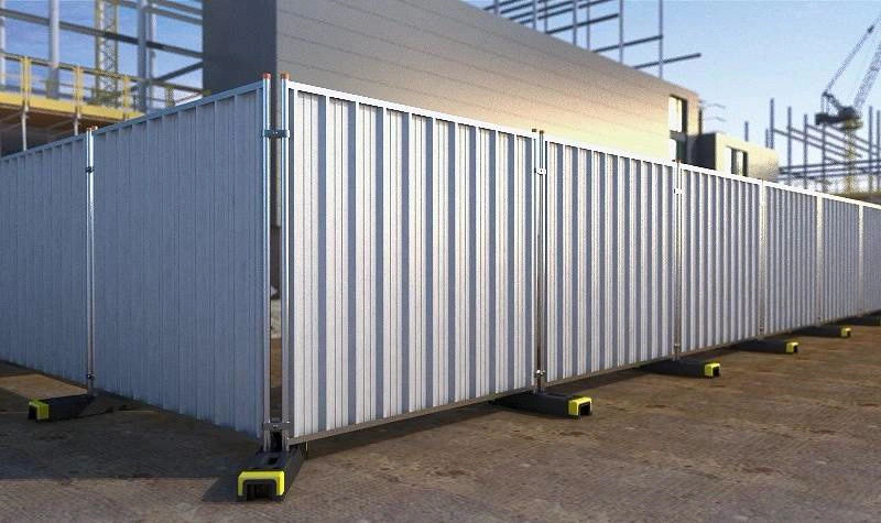

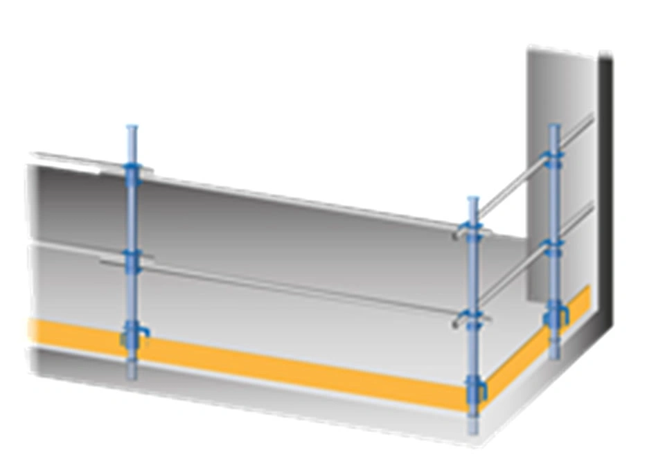

Reference Images
Temporary Hoardings for Construction Sites, Event Sites & Other Sites

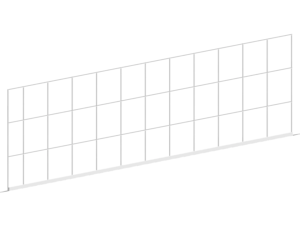

Safety Barrier Parameters:
Type of fence: Available options are “Bar” and “Mesh”. Bar option will generate the barrier made of vertical and horizontal post and bars. Mesh option will generate only the vertical posts and top horizontal bar; cavity is filled with transparent volume to represent the wire mesh screen.
Spacing between posts: Input values that controls the spacing between posts, the post spacing are consistent throughout the entire wall span, except for the last one that can be potentially smaller.
Number of horizontal bars: Input integer values that controls the number of horizontal bars. The value count includes the top bar. When using the mesh option from the “Type of fence” parameter, this parameter has no effect on the model.
Starting point offset: Offset the model at the start of the wall object.
End point offset: Offset the model at the end of the wall object.
Flip wall direction: Check to reverse the pattern of the vertical posts
Include kick plate: Check to include the kick plate, uncheck to exclude.
Flip kick plate: Check to move the kick plate to the other side of the fence.
Creating safety barriers:
  1. Create a wall object with the wall command
  2. Wall sketcher can be used to create with polyline profiles
  3. After creation, update the wall object with the barrier object type
  4. The barrier object will be generated using the same height of the wall and can be updated the same way as a wall object.
  5. Parameters are available within the wall dialog box to refine the model details
