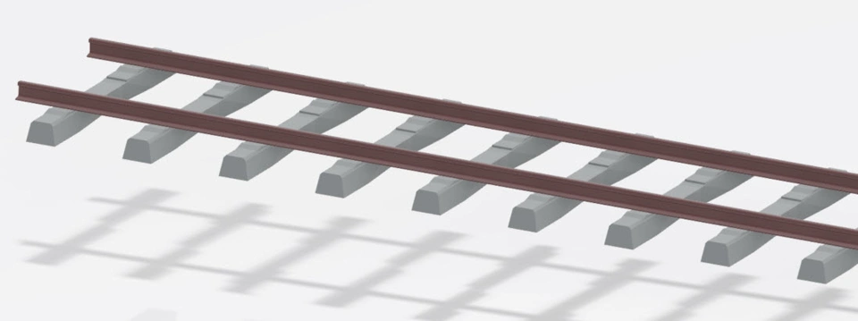

5 powercopies allowing the instantiation of rails & sleepers:
  1. Rails & Sleepers on subgrade
  2. Rails & Biblocks on concrete slab
  3. Rails only
  4. Sleepers only
  5. Biblocks only
Capability to instantiate separately sleepers and rails is provided to allow doing a mixt approach of a track with both biblocks and sleepers. Rails can be instantiated on top of that at the end.

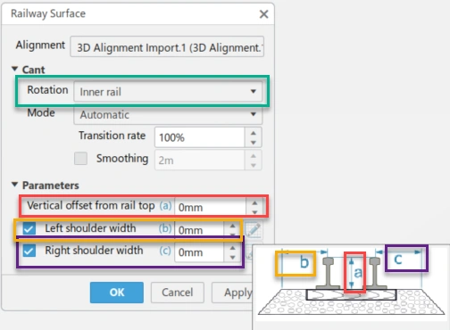

It requires the top of rail surface and curves as input. They need to be generated using the Railway Surface command from the alignment with the appropriate cant for your project (green below) and a vertical offset and shoulder width at 0mm.
