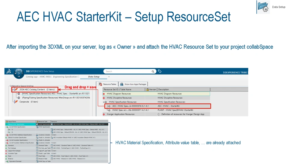

25x_HVAC3D_Setup_STD_ANSI_AddOn
How to install it
import the 3DXML , add the Engineering HVAC Part filter object into a HVAC specification
