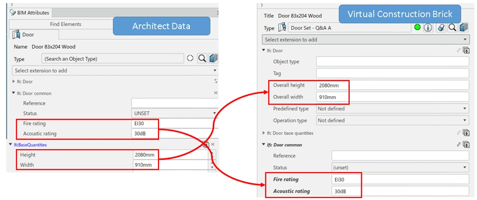

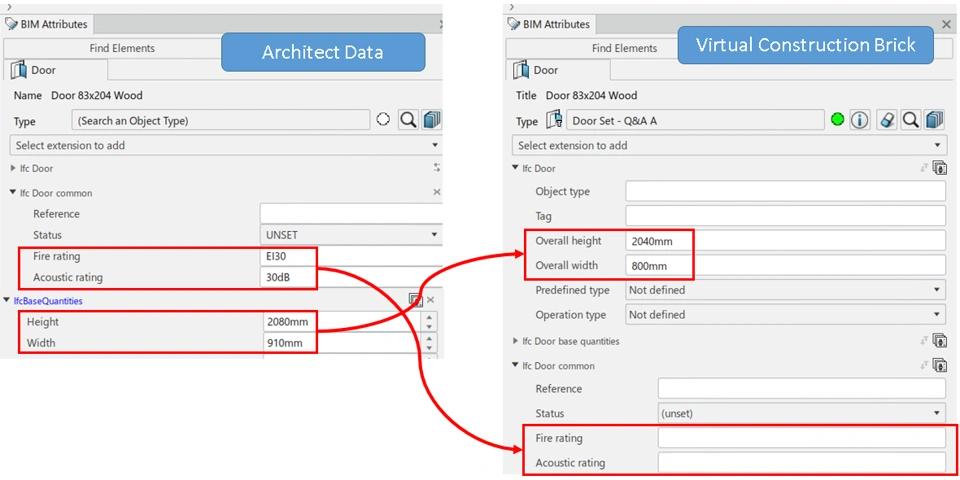

This guide includes a 3dxml with a set of architect doors and PLM AEC-typed products (see bottom of the page). We focus on the following attributes: Fire rating, acoustic rating, overall height and overall width. We want to transfer this information to the CATIA products attributes that are either empty or wrong.

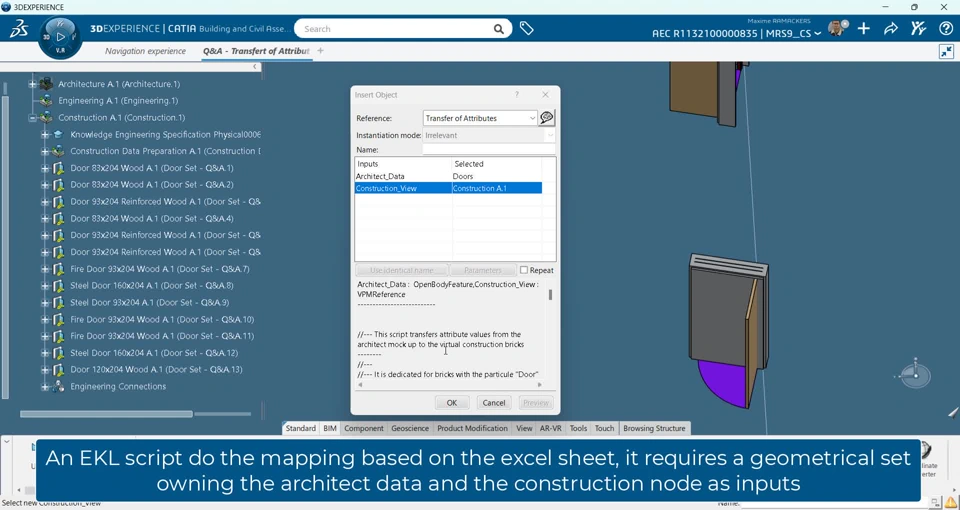

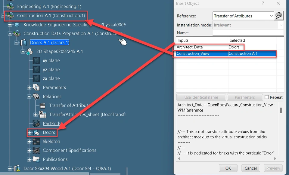

In the construction preparation data node, there is a design table with an excel sheet attached to define the mapping. Column 1 have the attributes from the bricks and column 2 the attributes from the architect,
Data sheet to configure attributes mapping This preparation node owns as well an EKL action taking as inputs the set having architect data and the construction node having the AEC-typed products,

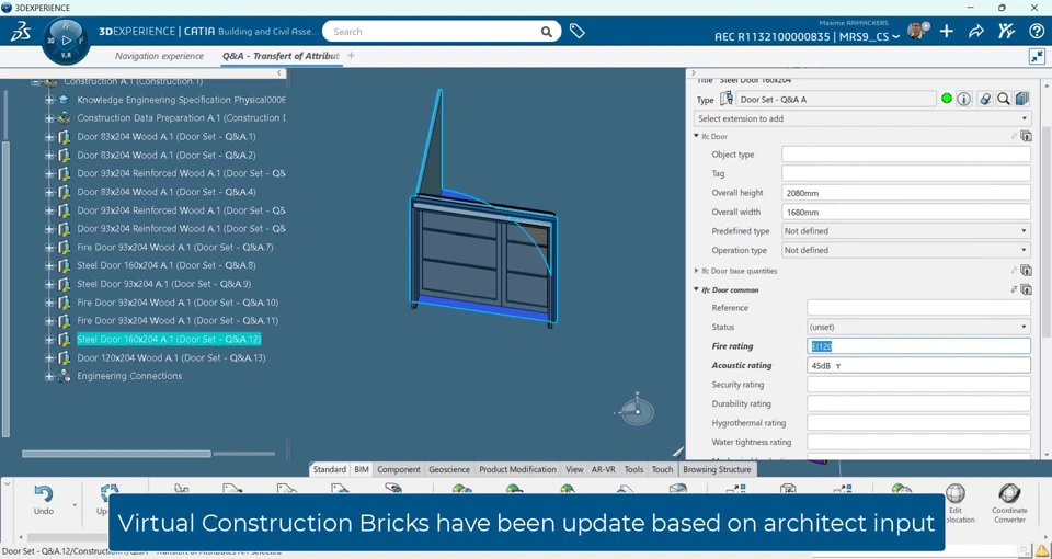

EKL action mapping Revit custom attributes at shape level to BIM attributes at PLM level Update the complete model to observe design changes. Check in the BIM panel that attributes have been filled correctly
Revit custom attributes mapped on BIM attributes
