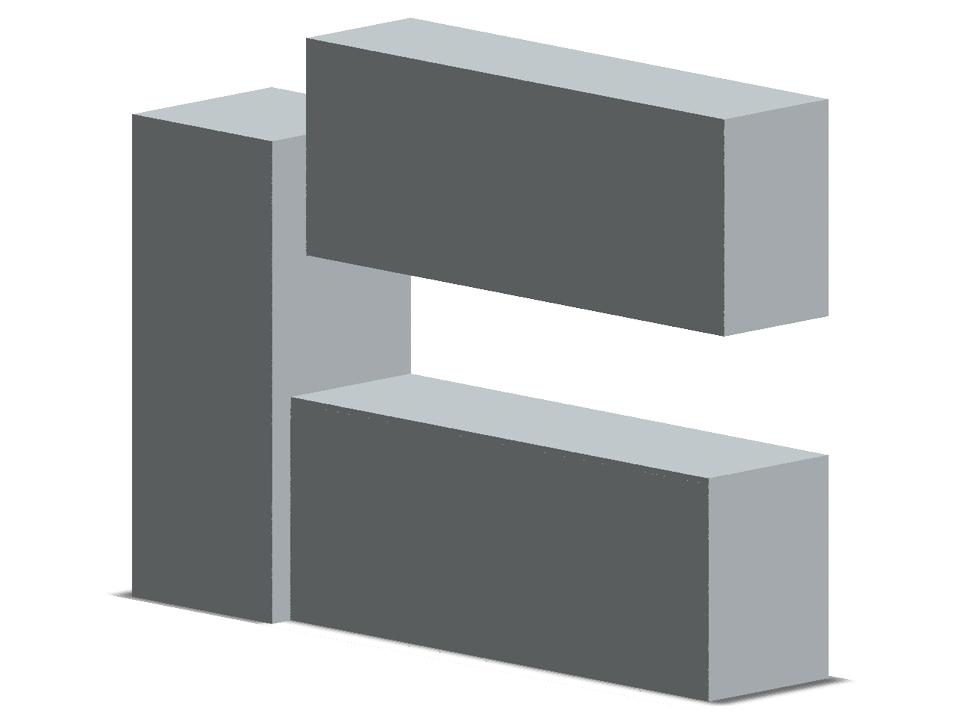

3DXML:
Object Type Name: OT_Kitchen_DEMO
Documentation:
Input Axis System:
The input axis system of the kitchen unit can be positioned on the left, at the center, or on the right side of the units. The X-axis is aligned with the depth of the units, while the Y-axis runs along their length.
Parameters:
- Position: Define if the base axis system inputs is positionned on the left, at the center or on the right of the overall kitchen units
- Refridgerator_Position: Define the side of the refrigerator compared to the cabinets.
- Refrigerator: A Boolean parameter to select if there is a refrigerator unit or not.
- Upper_Cabinets: A Boolean parameter to select if there are upper cabinets units or not.
- Base_Cabinet_Depth / Height: Define precisely the dimensions of the base cabinets.
- Upper_Cabinet_Depth / Height: Define precisely the dimensions of the upper cabinets.
- Cabinet_width: Define precisely the width of both upper and lower cabinets.
- Cabinet_Number: Specify the number of cabinets.
- Refridgerator_Depth / Height / Width: Define precisely the dimension of the refridgerator.
