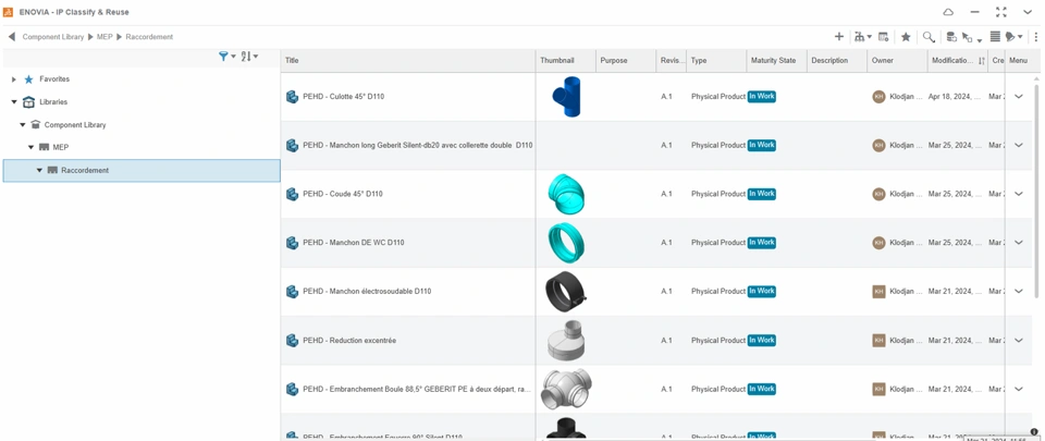

Library - Content organization with the ability to create custom attributes on content.
For example, Standard Parts (transformable and non-transformable parts) can be managed in a Bookmark, however, Libraries allow the addition of non-geometrical additional attributes like cost, production time, manufacturer, etc. Below is an example of a typical Library structure.

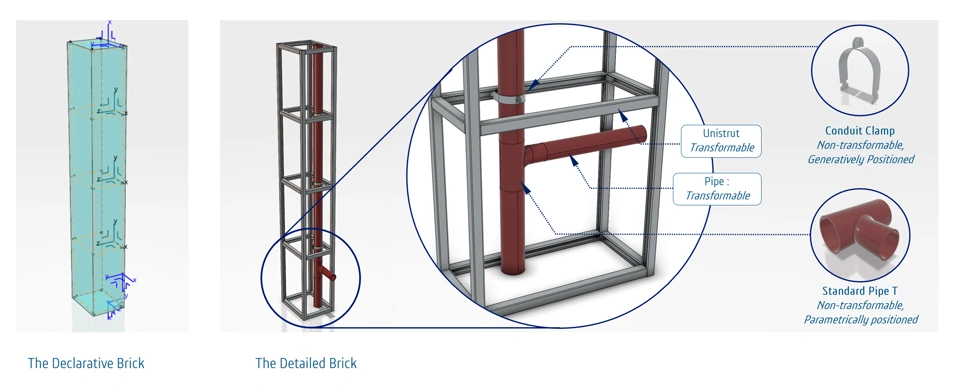

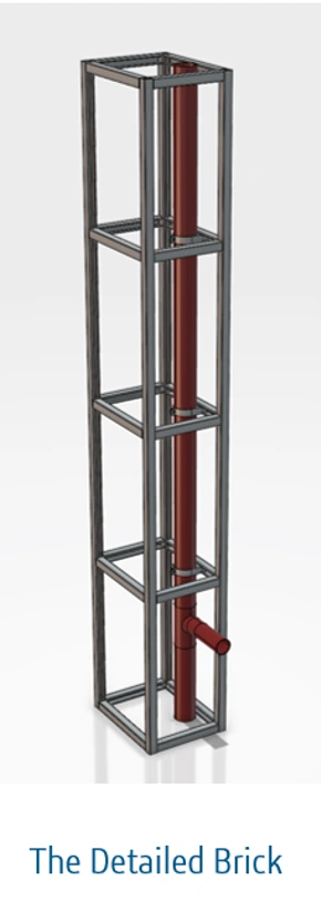

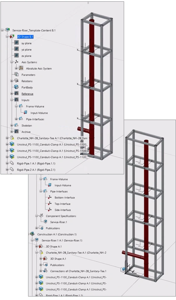

For the purpose of illustrating this Best Practice, we will use this mechanical riser as a demonstrator. The riser is assembled off-site composed of a Unistrut mechanical frame with a waste pipe connecting to a toilet with a standard pipe T. The pipe is fixed to the Unistrut with conduit clamps. Depending on the size of the riser, the Unistrut will automatically adapt with a new structure, positioning the Pipe T and inserting conduit clamps as required.
Below are examples of information relating to the VCB that a VCB Creator would want to prepare and maintain alongside the development of the Brick. Not all of these items are relevant to each Brick--we are providing them as Best Practice recommendation.

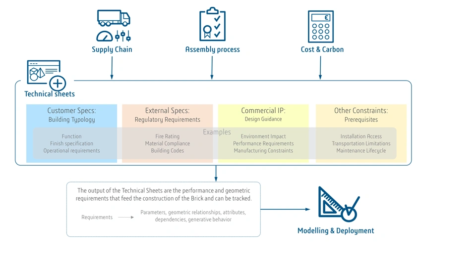

Technical Sheets : these describe the information required to create the Brick, they are a set of information extracted from design rules, regulations, production know-how, manufacturing constraints and corporate IP that become parameters and metadata in the virtual construction brick.
This set of information is produced by a Business Assessment referenced in the Virtual Construction Brick Wiki Page.

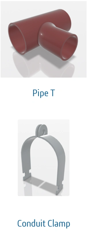

- Standard Components
- Non-Transformable (conduit clamp and pipe T)
- Transformable (pipe and Unistrut profiles)

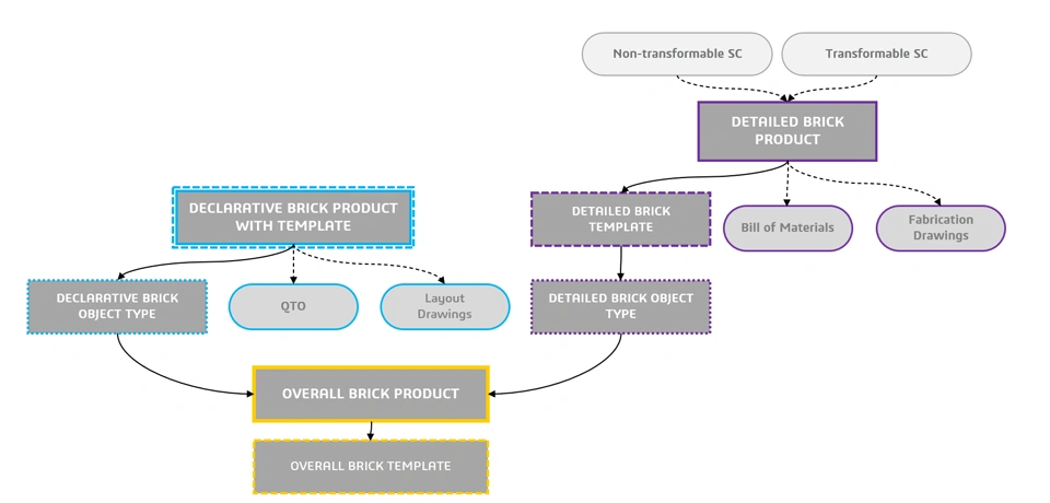

- Brick Products
- Overall Brick Product (Contains Declarative Brick and Detailed Brick Object Specifications linked to each other ready for automated instantiation.)
- Declarative Brick Product (Contains feature-level content and template definition.)

- Detailed Brick Product (Contains full Product Breakdown Structure for manufacturing)
- Bill of Materials as Knowledge Report
- Fabrication Drawings as Drawing
- Brick Templates
Complete Brick (Declarative + Detailed) specifications all set up(Starting point for Brick instantiation.)
No separate element for the Declarative Brick Template because it is contained within the Declarative Brick Product as a feature-level template.Detailed Brick Template (Linked to Declarative Brick through Object Specifications.)

The following diagram gives an overview of the Overall Brick Product structure that encompasses the Declarative and Detailed Products described above. The Overall Brick Product can be instantiated into a Virtual Construction Twin as part of a customer's workflow.

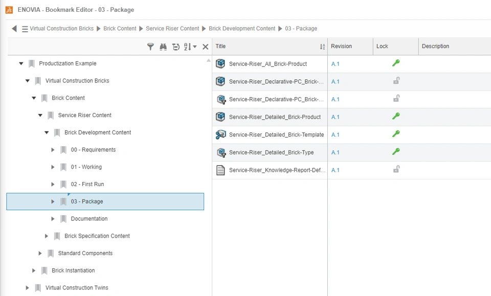

Organisation - Enterprise Bookmark Structure
Below is a recommended cohesive Bookmark structure for VCBs. As we will see, not all users require access (or visibility) to every sub-bookmark.
When initiating a new Brick, consider using the sample Bookmark structure below that shows how a Brick--and it's related content-- fits within a Company's collection of Bricks. You can either create the Bookmarks individually within Bookmark Editor or create a Windows folder structure and drag them into Bookmark Editor. This second method is illustrated here.

Standard Components (Both industry and company standard components of non-transformable and transformable parts.)
Non-Transformable
Transformable

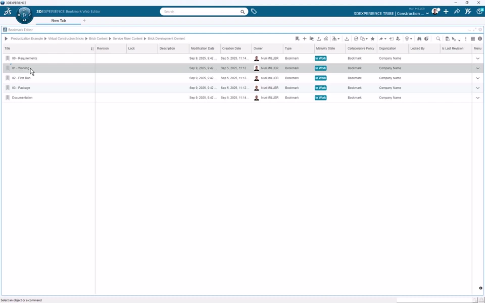

Brick Development Content
These sub chapter reflect the development of the brick. They can be very specific to a company's internal processes. We suggest developing a process for the development and include references to the WIP that may reflect the incorporation of construction know-how over time.
00 - Requirements - Requirement folder of the brick
01 - Working - Brick instantiation tests on Architecture or Engineering models. Development tests of the Brick product, template and components for different users.
02 - First Run - First test on an active construction project. Results of the instantiation of the Brick (3D model, deliverables).
03 - Package - The production content relating to the Brick (product, engineering template, report, document, standard components, user guide). This package can be exported in another tenant.
04 - Documentation - Useful documentation for the Brick developer (general good practices document, standards, business rules, prerequisites). It usually contains a description of the global application of the Brick from its instantiation, quantification, production of deliverables and the installation on site.
