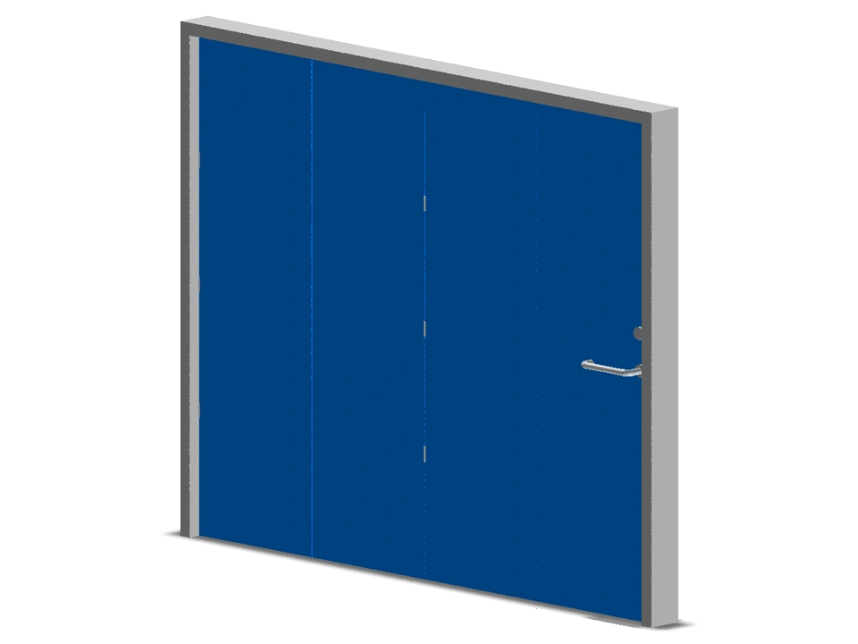

Folding Door
2026 content Door Adaptive

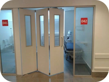

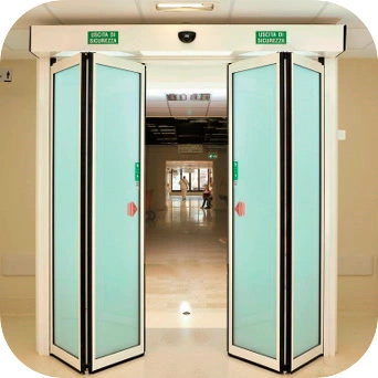

Reference Images
 Hospital Door Systems - Automatic & Manual Doors | Horton Automatics Interior door - FDA HOSPITAL - Ponzi - aluminum / folding / glazed Grupsa introduces ICU Doors HS-557CP – Grupsa Door Systems GCC
3DXML:
Object Type Name: OT-Door-Folding Door

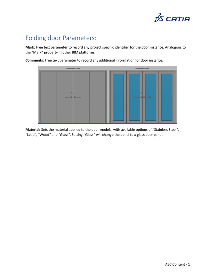

Folding door Parameters:
Mark: Free text parameter to record any project specific identifier for the door instance. Analogous to the “Mark” property in other BIM platforms.
Comments: Free text parameter to record any additional information for door instance.
Material: Sets the material applied to the door models, with available options of “Stainless Steel”, “Lead”, “Wood” and “Glass”. Setting “Glass” will change the panel to a glass door panel.
