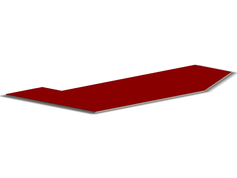

Floor/Slab Objects can be used with Building 3D Design to convert low-level slab features into higher-level slab features. These features can then be converted to an even higher-detailed product assembly structure.

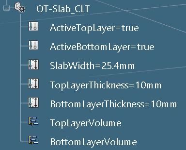

Parameters / Outputs
Note: Parameters will slightly vary depending on the floor/slab object-type selected

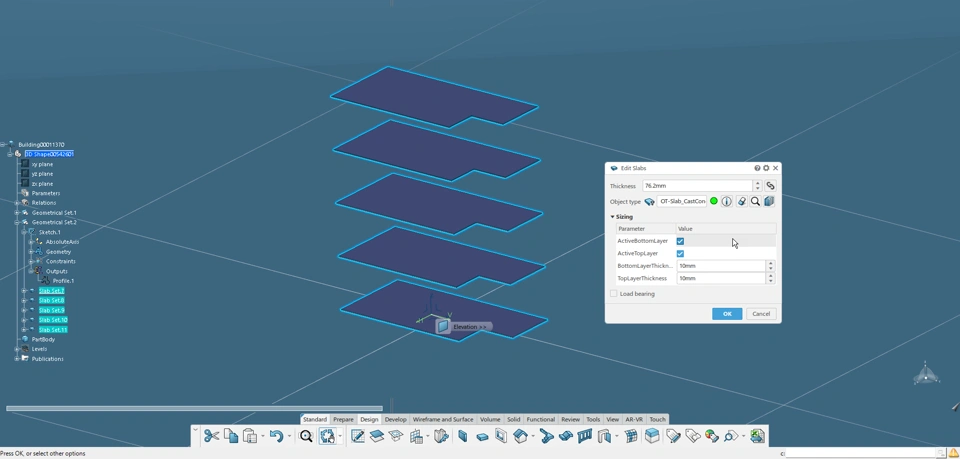

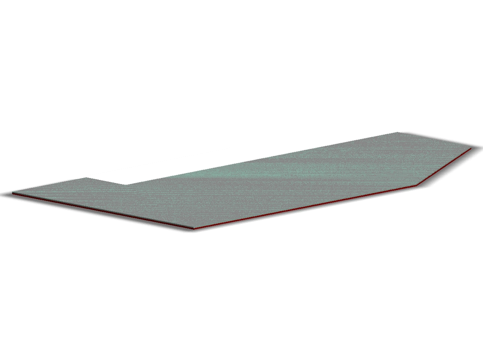

Create the desired slabs using the "Slab" function in Building 3D Design

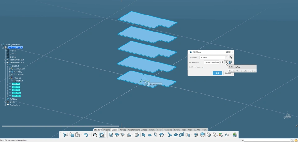

Shift-select the desired floor/slab(s) then select "Multi-Edit Slab"
Beside the "Object type" field, select the magnifying glass (Define by Type), and use the explorer to search for the desired floor/slab Object Type
Change the parameters as desired and click Ok. The parameters can also be changed at later stage by simply double-clicking the floor/slab

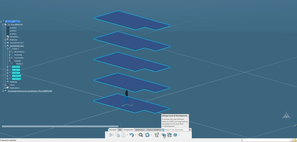

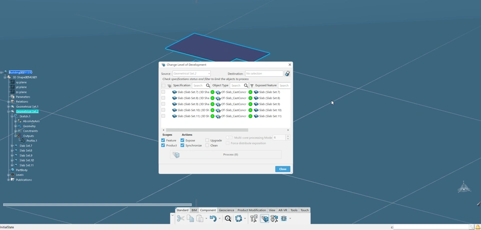

Be active at the product level and use the "Change Level of Development" function in the Building and Civil Assemblies app

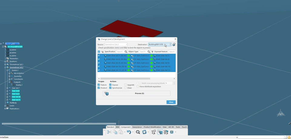

Click the 3DShape, Geoset, or other container housing the floor/slab geometry as the "Source". The available floor/slab(s) should be displayed
Check the desired floor/slab(s), and select the desired product as the "Destination"

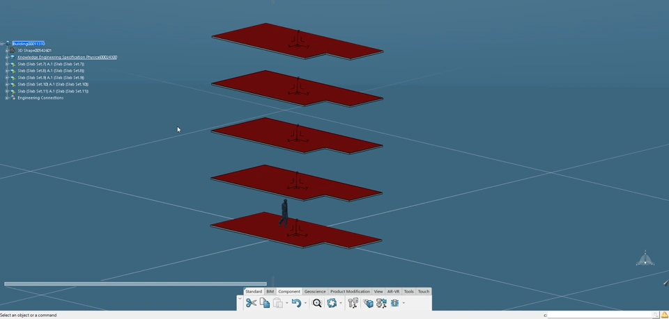

Select "Process." Once complete, the floor/slab assemblies should now be created in the desired product
