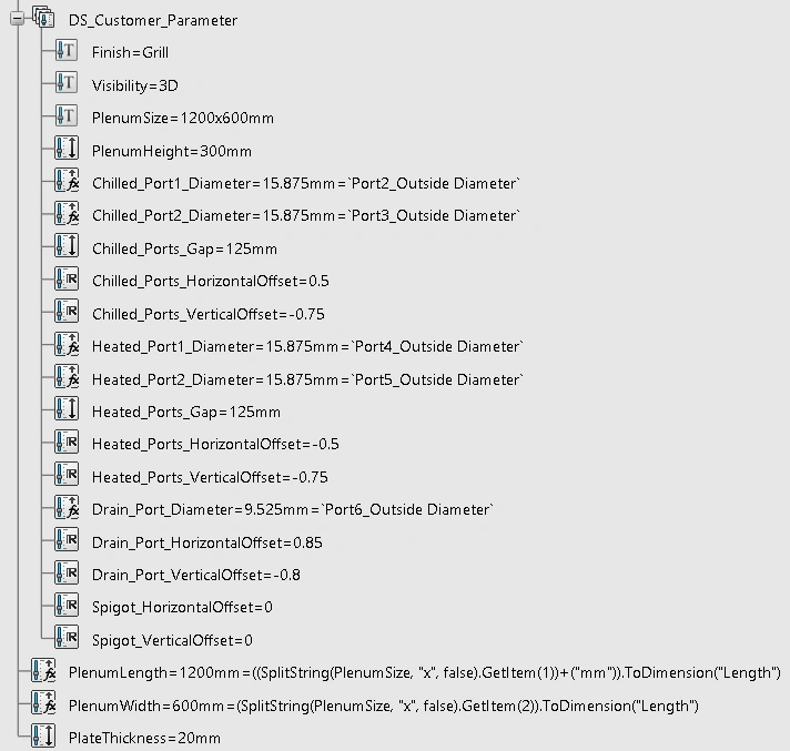

Features Embedded in the Part

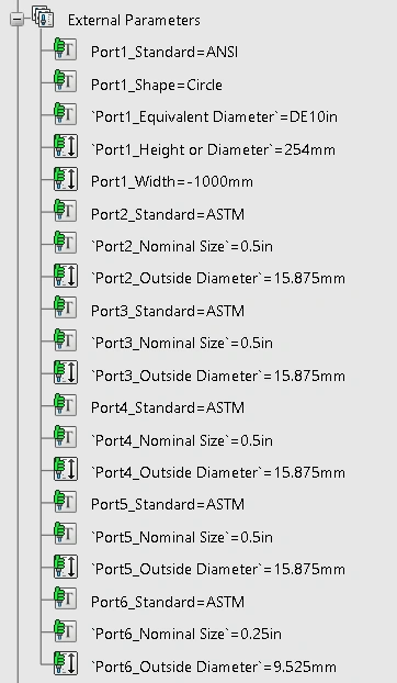

Configurable port parameters that control the geometry of the piping and spigot.

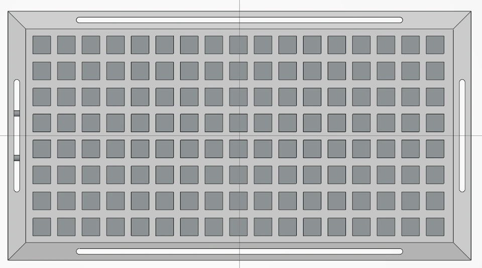

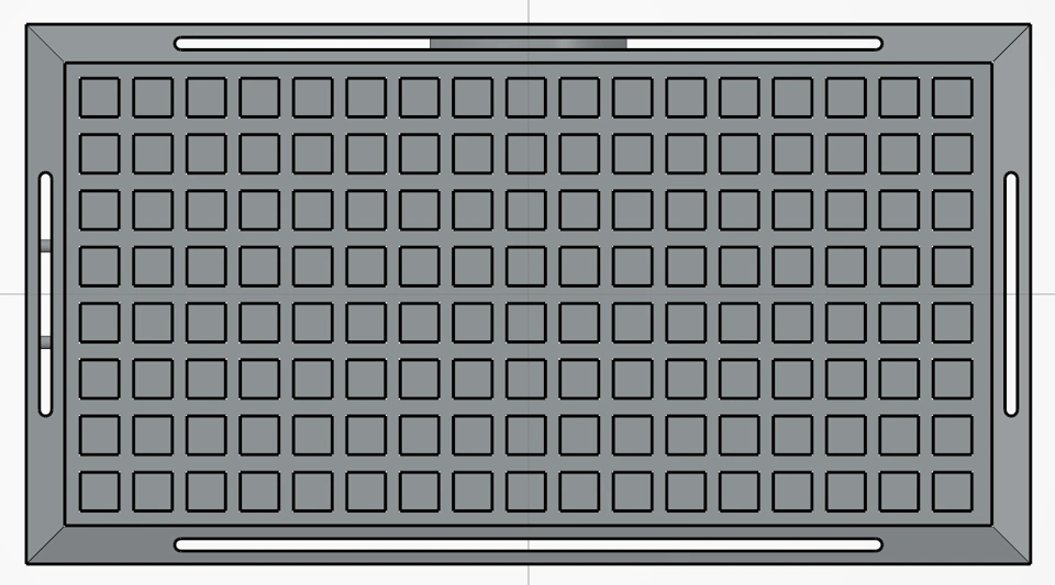

  1. Finish: Select the type of cover plate
    1. Grill
    2. Solid
  2. Visibility: Change the visibility of the equipment between 3D representation, 2D representation or both.
  3. Plenum Size/Height: Select the overall size of the chilled beam plenum

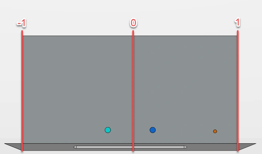

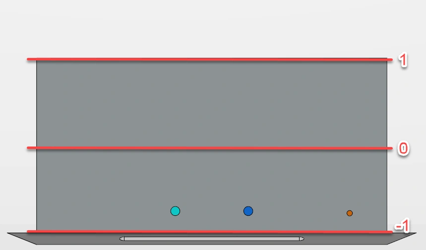

  4. Chilled/Heated/Drain ports and Spigot horizontal and vertical offsets:
    1. Horizontal: Controls the horizontal location of the ports using a ratio of the total width referenced from the mid-plane
    2. Vertical: Controls the horizontal location of the ports using a ratio of the total width referenced from the mid-plane
  5. Plate Thickness: Change the thickness of the cover plate.
