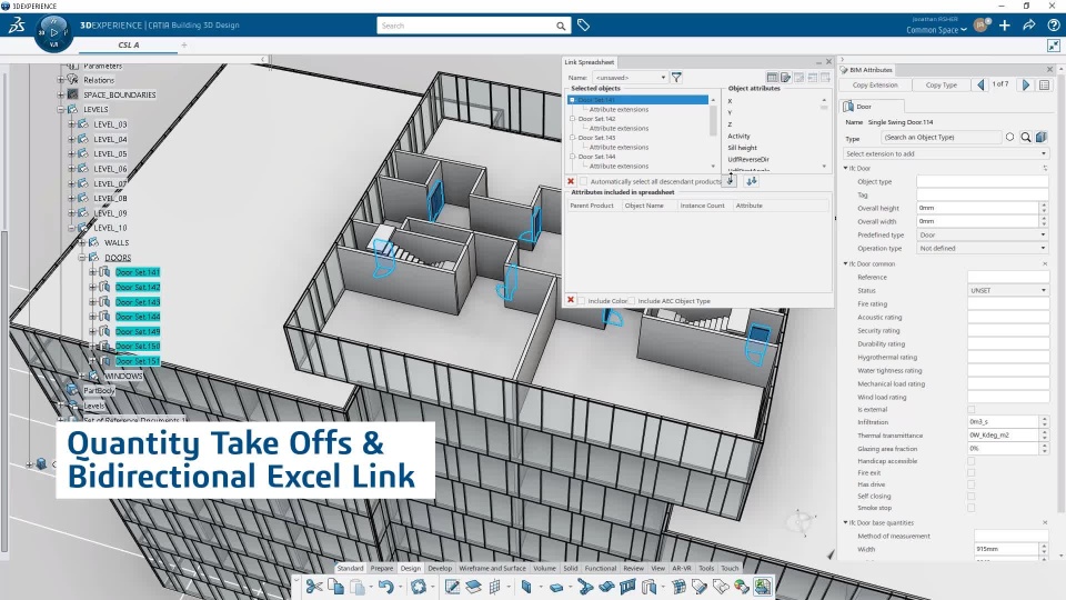

8. CATIA Building Design Fundamentals Part 8/8 - Quantity Take Offs and Shadow Casting: https://youtu.be/6amVMdTCyW8
