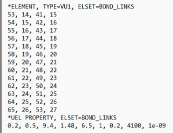

*USER ELEMENT, TYPE=VU1, NODES=3, COORDINATES=3, VARIABLES=11, PROPERTIES=9
1, 2, 3
The VUEL elements are defined as:
*ELEMENT, TYPE=VU1, ELSET=BOND_LINKS
and in the assembled model the element set becomes:
FIBERBONDPART-1.BOND_LINKS

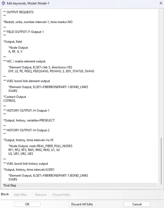

Initially, I requested the VUEL output as SDV9, SDV10, SDV11, but then changed it to SVARS:
** VUEL bond-link element output
*Output, field
*Element Output, ELSET=FIBERBONDPART-1.BOND_LINKS
SVARS
I also tried history output:
** VUEL bond-link history output
*Output, history, time interval=0.0001
SVARS
Even after requesting SVARS, the VUEL variables are still not visible in Visualization. Only the HJC/matrix SDV variables are available.

1. *USER ELEMENT definition screenshot:
2. *ELEMENT, TYPE=VU1, ELSET=BOND_LINKS and *UEL PROPERTY screenshot:
3. Keyword editor screenshot showing SVARS in field and history output:
