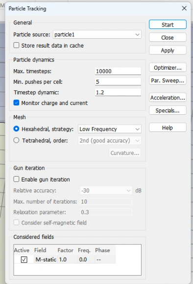

I want to simulate the deflection of a beam by a scanning magnet. The coils are solids constructed by scanning a path, but errors keep occurring during computation:
When using the Hexahedral FIT mesh, an error is thrown directly with the following message:"The hexahedral-based solvers do not support solid conductor types for coils. For coil 'coil1' a stranded conductor model will be used. The hexahedral-based solvers do not support solid conductor types for coils. For coil 'coil2' a stranded conductor model will be used. Computation of coil 'coil1' failed. Profile is not sufficiently planar."
When using the Tetrahedral mesh, the following error occurs:"M-Static Solver (TET): Terminated abnormally; M-Static Solver failed."
