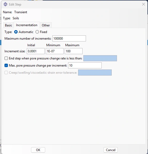

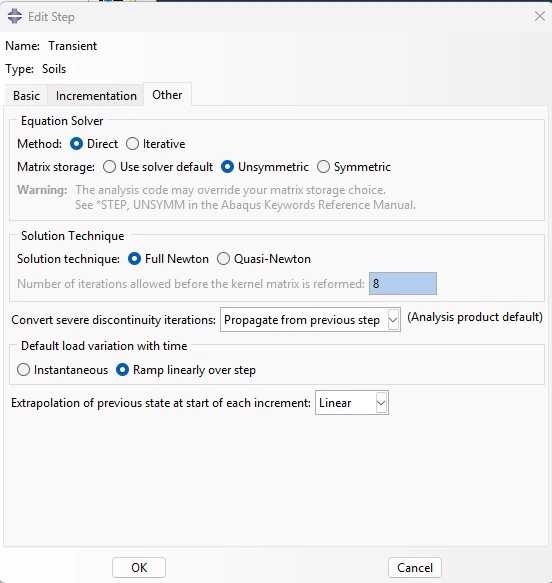

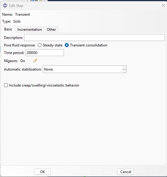

I am currently working on an infiltration analysis in Abaqus/Standard and have been facing persistent convergence and stability issues during the simulation. I would greatly appreciate any guidance or suggestions from the community.

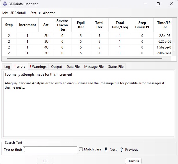

The model involves coupled infiltration behavior, and during the analysis I encounter issues such as:
- Too many attempts made for this increment
I would like to understand:
- What are the common causes of these issues in infiltration or seepage-related analyses?
- Which modeling aspects should be checked first (material properties, boundary conditions, mesh quality, permeability definition, step settings, etc.)?
- Are there recommended strategies in Abaqus/Standard to improve convergence for coupled pore pressure–stress problems?
- Would stabilization techniques, mesh refinement, or different increment controls help in such cases?
I have already tried adjusting increment sizes and reviewing boundary conditions, but the problem still persists.
