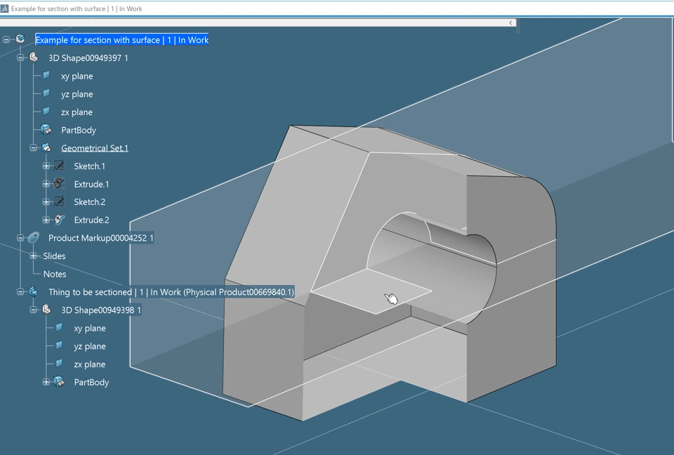

I'm using the "Sectioning using surface" command in Enovia Design Review.
It works well when the surface only has one section (like the wavy surface extruded from a spline in one of the screenshots). When I make a surface with multiple sections, like the second screenshot with an extrusion from a two-line segment sketch, the section looks a little wonky.
I noticed that it doesn't select the entire surface, and I cannot select the surface from the tree, only from the 3D Geometry itself.
So, it only selects one of the faces, and then returns a partially sectioned shape.
Am I missing a preference/setting/step to allow me to select the entire surface?
Any other insights that may help with this behavior?
