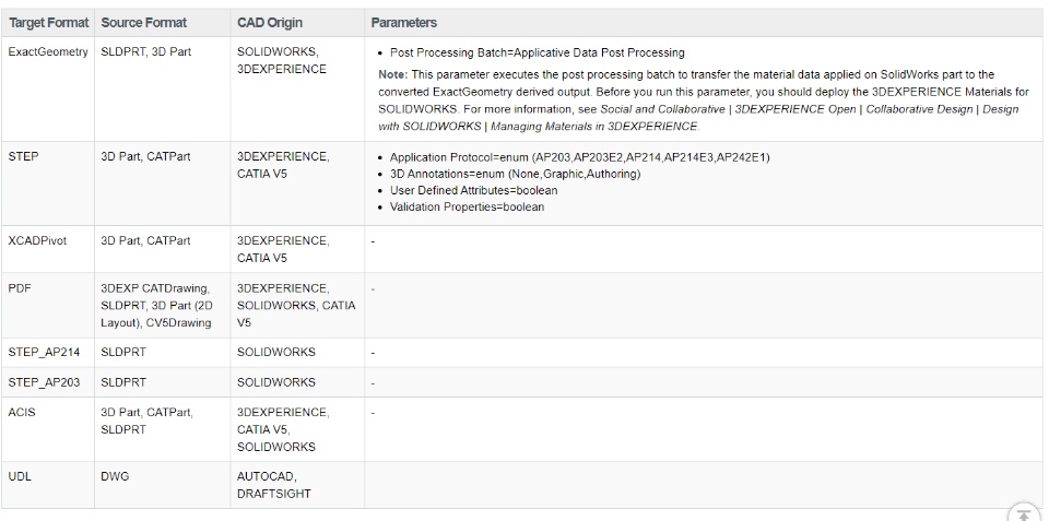

Hi, we are working on customer solution, to automate the creation of derived outputs by using the derrived format converter on a seperate machine. My questions:
Source NX part - > target STEP - necessary role PCS+STS?(named or shareable?)
Source CV5 part -> target STEP - necessary role PCS + UE5? +STS?(named or shareable?)
Source CATIA 3DX - target STEP - necssary role PCS+EXH?+STS?(named or shareable?)
Unfortunately I don´t find any information about STS licensing in the documentation and also a table that shows NX is not possible, but with R2021xFD10 and R2022x GA it works.
I need clarification on installation, functionality and licensing.
Many thanks in advance
Derived Formats - User Assistance R2022x (3ds.com)
