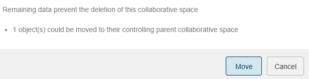

I’m platform admin and Leader/Owner of a collaborative space on a 3DEXPERIENCE cloud tenant, and I’m trying to delete this CS that looks completely empty: when I search with Collaborative Space = this CS and all types / all maturity states, no objects are found. But when I delete the CS I get the message “Remaining data prevent the deletion of this collaborative space – 1 object(s) could be moved to their controlling parent collaborative space”, and when I click Move I get “Some errors occured while cleaning collaborative space: Invalid Collab Space. Invalid Owner. Invalid Organization.” It looks like there is a “ghost” object still attached to this CS that I cannot see or move from the UI. Has anyone faced this and knows how to identify/clean that hidden object so the collaborative space can be deleted?
