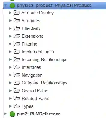

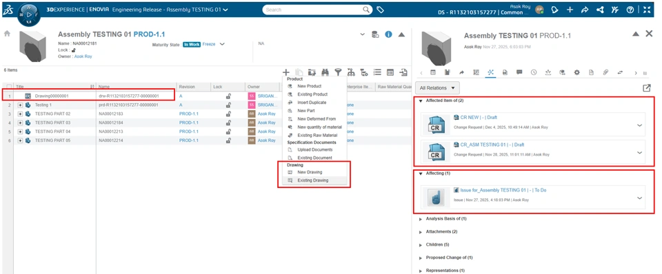

I’m designing a report template for Physical Product, but I’m unable to fetch data for some objects linked to the physical product. Could you please advise which methods can be used to retrieve this data shown in the images?
  1. Below image shows the connected elements to the physical product and available methods.
    I’m unable to retrieve the following elements using the available methods,
    i) Drawings (CAD Drawings)
    ii) Affected Items (Change Requests Object)
    ii) Affecting (Issue Object)

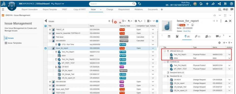

  2. Below image shows the the issue object, its connected object, and available methods.
    I’m unable to retrieve the following element using the available methods,
    i)  Affected items (Physical Product)
