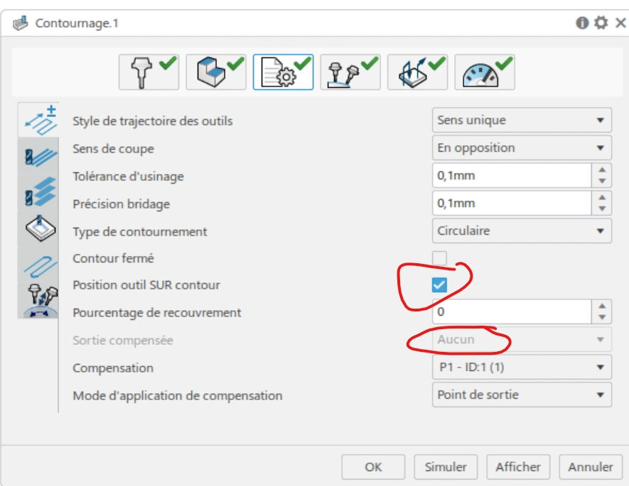

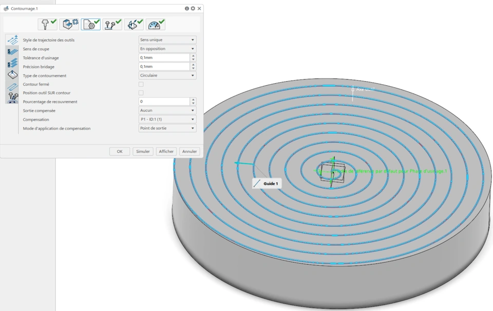

I'm trying with 3dexp to program a contouring with cutcom with a special curve : a spiral.
I have got a problem because the milling cutter wants only to do a turn : i think the milling cutter cannot penetrate the guide :
If i check the box "on curve" it is working (the milling cutter follows the entire drive curve) but i can't choose now the CUTCOM option :
any idea to solve this problem ?
