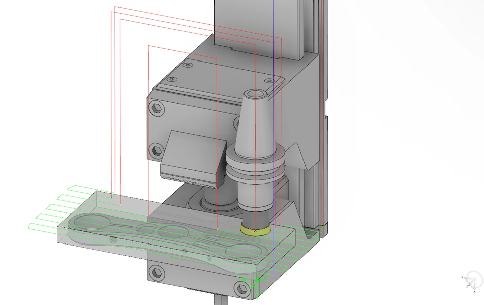

Hello,
I am looking for a solution to a problem that occurs during face milling with an insert-type cutter. A tool of this design cannot enter the material with a vertical plunge movement, because this causes collisions between the cutter body (where there are no cutting inserts) and the workpiece material. Despite enabling the collision avoidance option, toolpaths are still generated with colliding movements. I would expect the toolpaths to be trimmed and arranged in such a way that machining always starts outside or beyond the workpiece. Could you please advise me how to program face milling with such a cutter?
