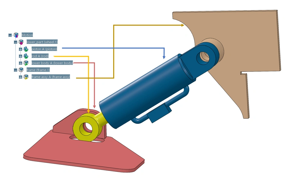

I am currently working on creating motion for a complex assembly and have configured the assembly as a Flexible structure. However, I’ve encountered an issue where the Flexible option does not seem to function correctly when creating the mechanism and joints.
I previously understood that MKM (Motion Designer) included all the features of MMO (Mechanism Motion Designer), but it feels like some functionalities might be limited or behaving differently.
Has anyone else experienced this issue with Flexible assemblies in MKM? Is there a specific setting or workaround required to enable Flexible behavior during joint creation?
