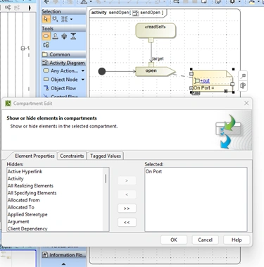

I used Flashlight.mdzip (obtained through Cameo documentation library) as an example to create a low-fidelity model and simulation of a radio system.
The activity diagrams from my model match the activity diagrams from the Flashlight project, with the exception of the On Port indication (see following images).
Flashlight Act diagrams have On Port = Out in the compartment.  My model has On port = in the compartment, but I am not able to put the "out" port in the compartment.
2 Questions:
  1. Does anyone know why I am unable to visually re-create the Anchor as shown in the sendStart Act diagram from Flashlight, even thought the specifications match?
  2. Does anyone know if this difference matters for a simulation (My simulation flow beyond this point is broken, so I wonder if this is the problem)?
Activity diagram from Flashlight.mdzip
Activity diagram from my model.
