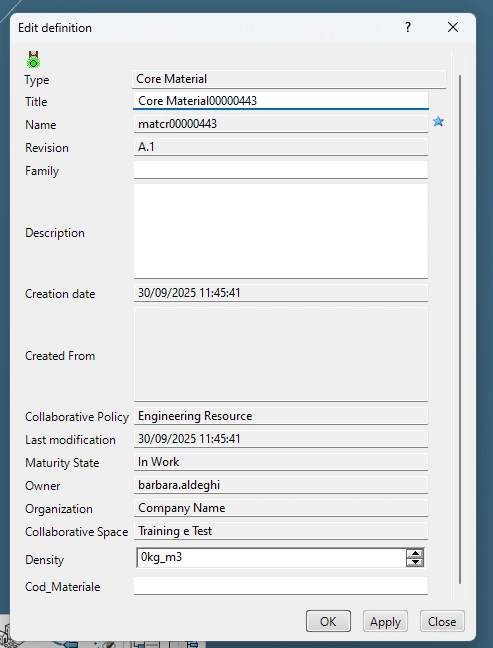

I am once again asking for your help. I need to know where I can find these Psets in the platform: Material Profile Set for aluminium and steel, and Material Layer Set for layered glass
I made a mock up of an AEC Member object and applied a dummy material to it, but I can't see its material properties once exported as IFC. Is it because the material is just...a core material and not a construction material or engineering material (like concrete, reinforce concrete, steelS355...)? If so, how do I make one? Or where
I looked around (asked AURA) and found there is a "Material Assignement" or "Physical Properties" command but I only have these (Material Browser, Pick Material, Remove Material, Create Material, Duplicate Material).
What should I do?
