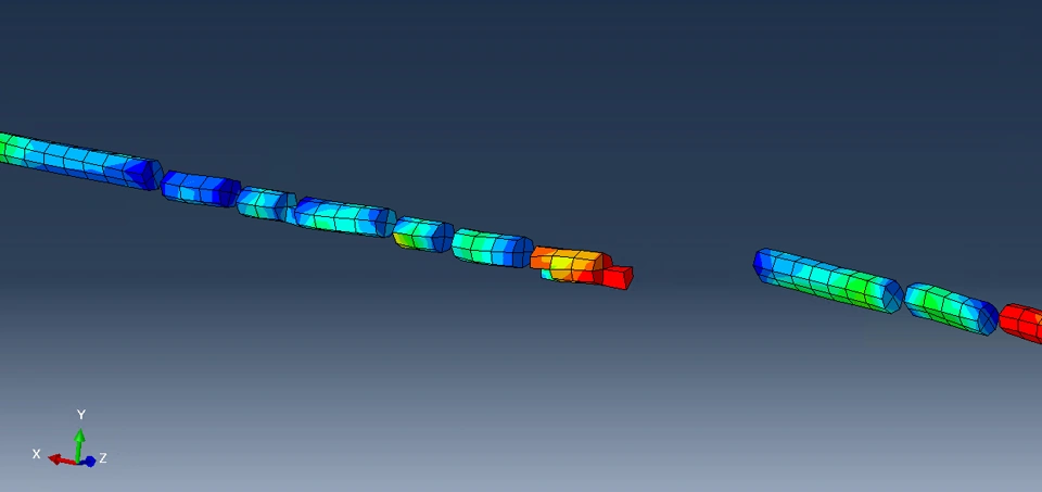

However, I am encountering an issue where the workpiece exhibits premature, nonphysical deterioration before and during the cutting stage. Instead of observing localized damage at the cutting interface, the material fragments into multiple segments along its length, including regions that are not in direct contact with the cutter.

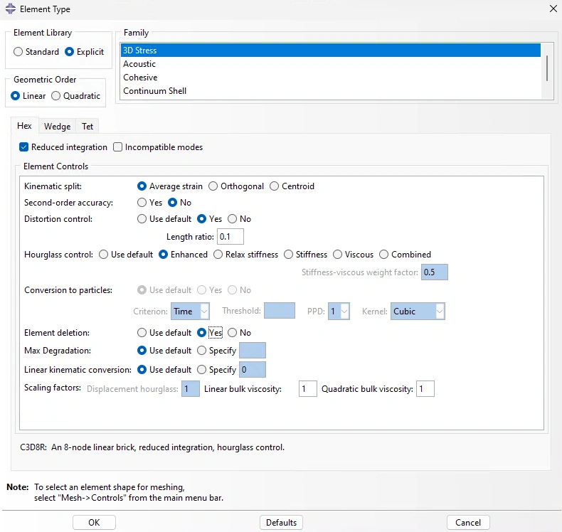

The mesh of the workpiece is Sweep Hex, element type, and material properties are summarized below:

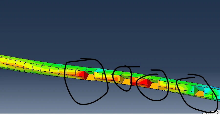

The workpiece appears to be fragmenting into small segments before or during the cut, and the model is removing elements too early, not only at the intended cutting zone as shown below:
My goal is to achieve localized damage at the cutting interface and not other points. I have some questions that need your technical insights:
