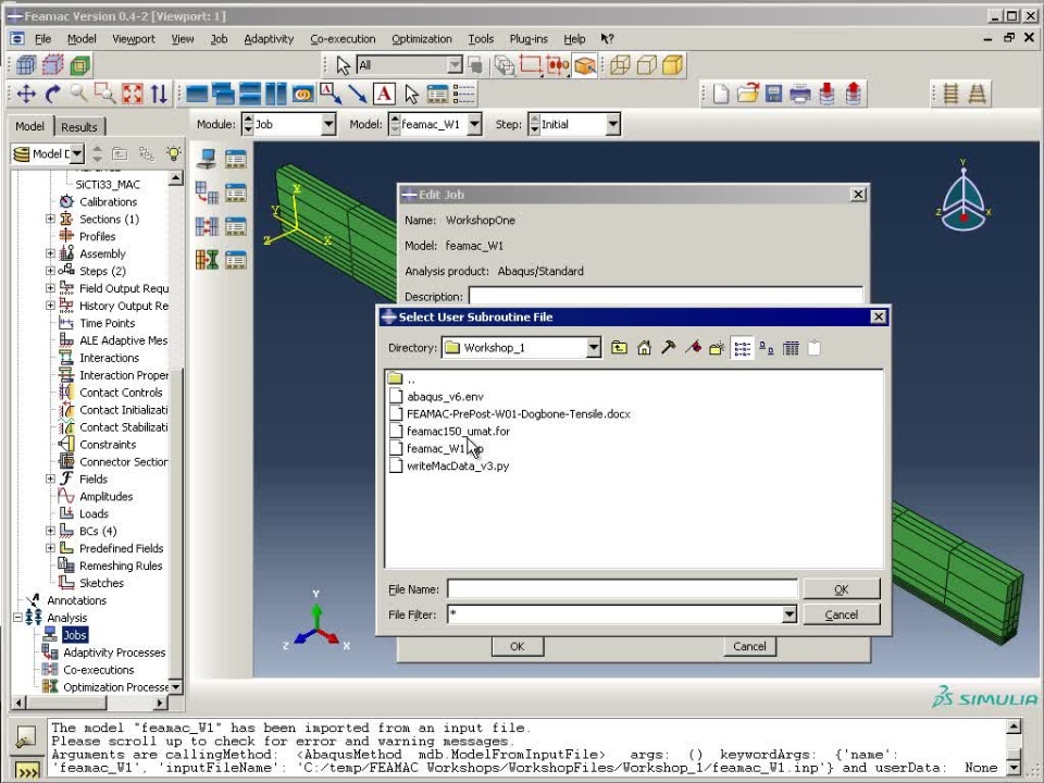

FEAMAC-PrePost Plug-in:

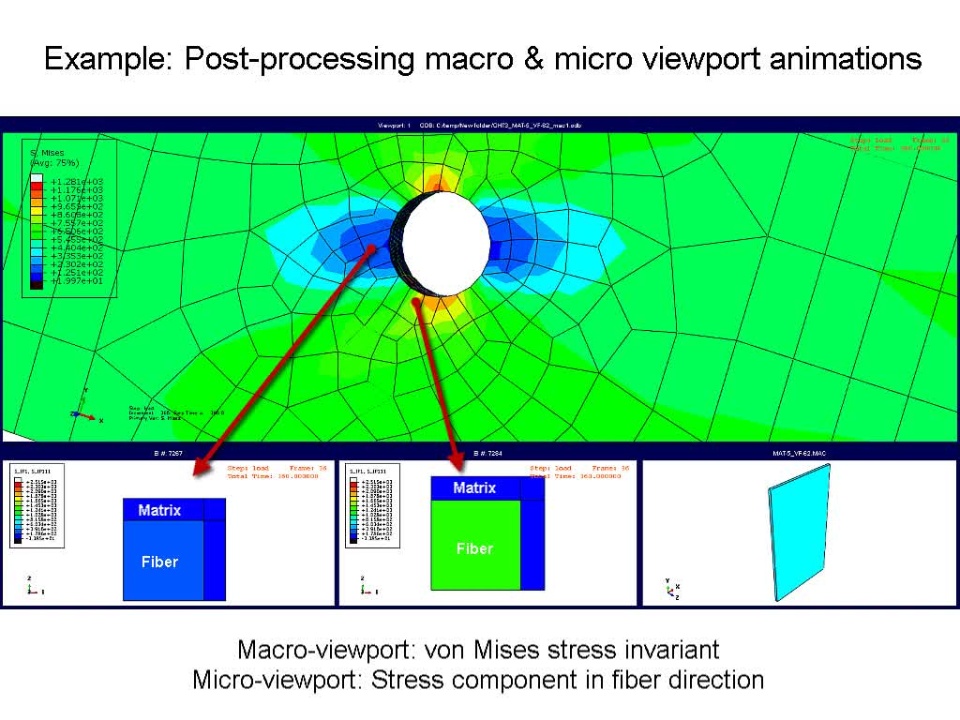

As mentioned in the previous video, a plug-in called FEAMAC-PrePost is available for use with the FEAMAC software which allows for seamless integration of the multiscale analysis directory with Abaqus/CAE. It provides a simple user interface for pre-processing as well as post-processing a multiscale analysis with FEAMAC. A sample is shown in the short  video (~8 seconds) below, where local fiber/matrix stresses in two separate locations in a composite laminate are simultaneously viewed along with the composite level stresses.
A demonstration of using  the FEAMAC-PrePost plug-in for a workshop tutorial can be seen in the video link below (~12 mins). In the example problem, a metal-matrix composite is modeled using the FEAMAC software to provide the overall composite response which considers the SiC fibers in a viscoplastic titanium matrix.
