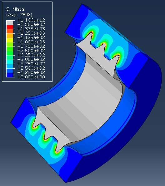

This article with step-by-step instructions and accompanying files with descriptions (CAE file, python scripts and user element subroutine - provided below) is meant to help Abaqus users new to mesh-to-mesh solution mapping get started. The attached CAE file has an axisymmetric model of a pipe with threads (teeth) on the outer surface inside another pipe. This example model simulates the indentation of the inner surface of the outer pipe by the threads (teeth) on the outer surface of the inner pipe. The mesh-to-mesh solution mapping capability in Abaqus allows this simulation involving extreme deformation due to indentation to successfully run to completion. This model can be modified by users to meet their specific model requirement.
IMAGES:  Sharp indentation of inner surface of outer pipe by threads (teeth) on outer surface of inner pipe (normal and sweep views)
VIDEOS:  Sharp indentation of inner surface of outer pipe by threads (teeth) on outer surface of inner pipe (normal and sweep views)

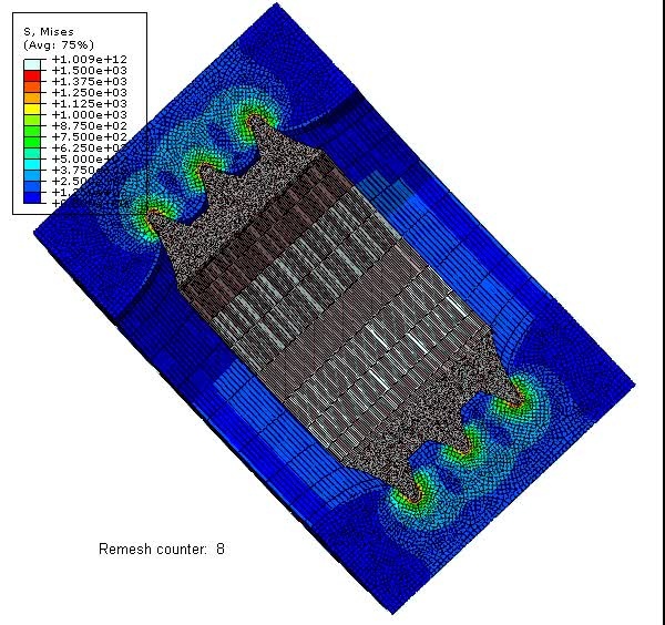

2. Run the script (File>Run Script…) ‘simulationDriver’. You can monitor the command prompt to see the simulation progress. The entire script should take approximately 10 minutes to run.

2.2. trigger.for: The inner pipe is displaced towards the outer pipe to cause indentation. Every time the inner pipe displaces 1 unit towards the outer pipe, the user element subroutine ‘trigger.for’ calls XIT to terminate the analysis and signal a remesh point. This prevents the elements from getting distorted excessively and compromising result accuracy.
2.3. copyModelAndReplaceMesh.py: Copies the deformed meshes of the old model to a new model, coverts them into new parts and remeshes them.
2.4. redefineSets.py: Redefines the sets used for applying the boundary conditions and sensor definition (that works with trigger.for to terminate the analysis).
2.5. redefineFacesAndSecAssign.py: Redefines the faces used for section assignments, and the sections assignments.
2.6. mapSolution.py: Transfers solution variables from the old analysis to the new mesh.
2.7. createJobAndWriteInputFile.py: Creates the analysis job and writes the input file.

3. Once the analysis completes, play MESH_ANIMATION.AVI and MESH_ANIMATION_SWEEP.AVI generated in the working directory to see results.
