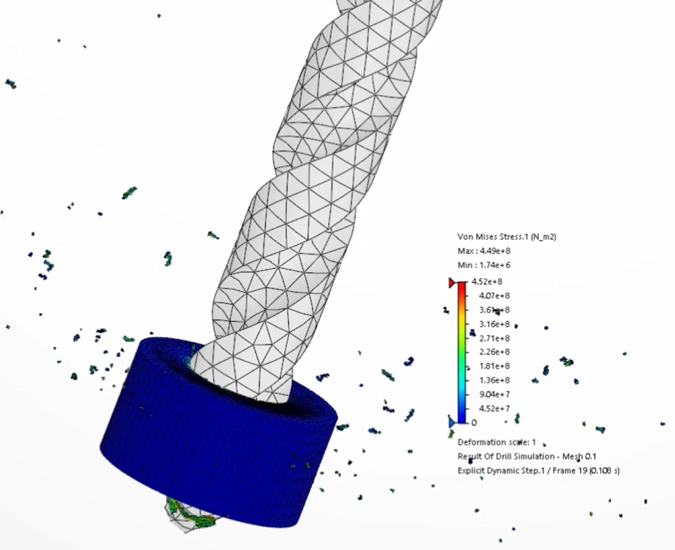

After the Keyword Edit was applied, the drilling simulation allowed for:
Elements of the workpiece to fail (e.g., due to material removal).
Contact between the drill and workpiece defined via node-based surfaces for accuracy.
Together, these edits allowed the drilling simulation to better represent material damage, element removal, and drill penetration through the workpiece.
