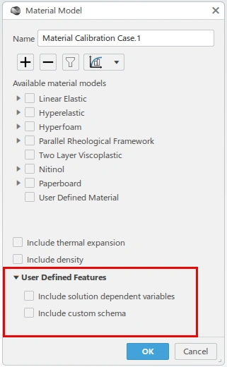

Addition of solution dependent variables and user custom schema as a first class material option, available for all user subroutines.
These 3 items are now available across all user-subroutines:
  1. Solution Dependent variables (state variables) available for all user-subroutines
  2. Custom Schemas can now be used for all
  3. *User Defined Field, Type=Specified   26x FD01 Calibration : *User Defined Field, Type=Specified

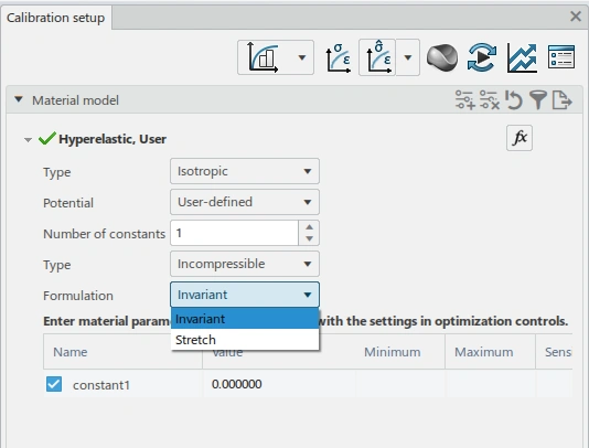

Addition of “Formulation” option to user-defined hyperelasticity.
Formulation = Invariant   ➡️     Abaqus UHYPER user-subroutine
Formulation = Stretch     ➡️     Abaqus UHYPER_STRETCH user-subroutine
See this post on the SIMULIA Community for a demonstration of both UHYPER and UHYPER_STRETCH.
