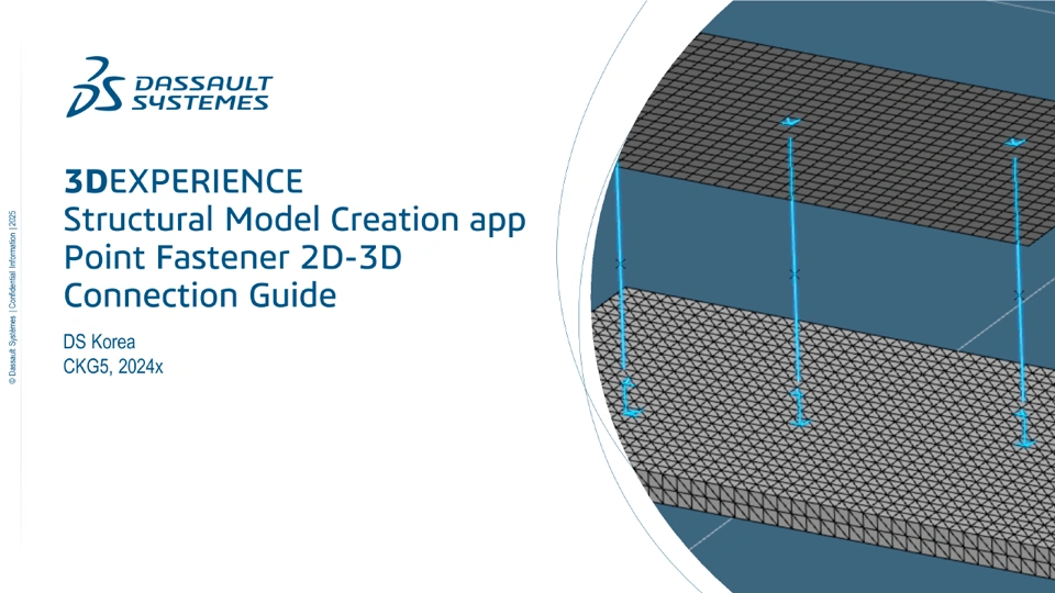

3DX Structural Model Creation app Point Fastener 2D-3D Connection Guide (Korean ver.)
Summary of 3DEXPERIENCE Structural Model Creation: Point Fastener 2D-3D Connection Guide
This guide provides detailed instructions on how to create point fastener connections between 2D Shell mesh parts and 3D Solid mesh parts within a complex assembly modeling environment.

2. 2D-3D Hybrid Mesh Connection (Point Fastener)
The core challenge is overcoming geometric differences when connecting inconsistent mesh types (2D Shell vs. 3D Solid).
  • Auto-Detection Feature: When a user selects the faces to be connected, the system automatically detects fastener locations within that range and establishes the links.
  • Flexible Search Range: By using right-click options to set a search radius, users can accurately implement joints between parts that are slightly gapped or possess different dimensions.
  • Coupling Technology: Appropriately distributes the load from a single point fastener to the surrounding 2D/3D elements to minimize artificial stress concentration errors.
3. Key Settings and Verification Steps
The guide outlines specific operational steps to ensure an accurate connection:
  • Support Definition: Assign the geometry or mesh of the upper and lower components where the load will be transferred.
  • Property Configuration: Input physical characteristics such as the fastener's diameter, material, and stiffness.
  • Function Test: A validation procedure to confirm that the created fasteners are correctly seated in their intended positions and that no connections are missing.
