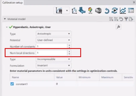

26x FD02 : Calibration of UANISOHYPER_INV usersub
As of R2026x FD02, there is still a bug related to this user-subroutine. The user-subroutine allows the user to set a "number of local directions", but this is not yet supported in the calibration app.   The screen shot below is from a development version (as of 5-5-2026).
